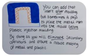

But sometimes plastic needs a bit of a helping hand. It might be the bore in an all plastic pulley that wears too quickly, or tapped in holes in moulded handles and knobs that are prone to stripping. Well, you can have the best of both worlds by bolstering these areas with a metal insert.
You can of course add that insert after moulding, but sometimes it pays to place the metal insert into the mould before plastic injection. By doing so you will eliminate secondary operations and ensure a robust mating of metal and plastic.

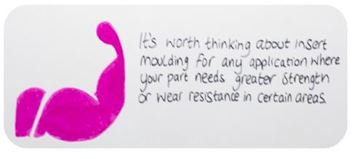

Well it’s worth thinking about for any application where your plastic part needs greater strength or wear resistance in certain areas.
Any plastic component that is attached to a mating piece with screws or bolts is a prime candidate. Another is for a bearing surface where a bronze or brass bushing will increase the product life, perhaps for a fan blade or a drive gear.

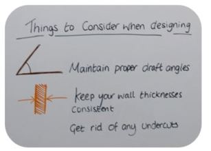

When it comes to designing the part, the good news is that you need to think about the same things as for any other injection moulded part. Maintain proper draft angles, keep your wall thicknesses consistent, get rid of any undercuts, in fact all the usual stuff that we’ve talked about in our previous Insight videos.

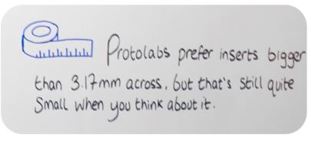

As I have said, most suppliers will probably hand load the insert into the mould. Those moulds are normally quite warm, so the operative will be wearing gloves. You know what it’s like trying to handle small fiddly things while wearing gloves, well it means that they may ask for a minimum size of insert. At Protolabs for example, we prefer inserts bigger than 3.17mm across, but that’s still quite small when you think about it.
