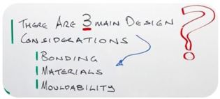

This all means that overmoulding is an incredibly useful process, but there are three main design considerations we need to bear in mind when we’re using it.
Overmoulding for injection moulding
First, we need to think about the bonding itself, which needs to be as strong as possible.
Second, the materials. The substrate and overmould need to be physically, chemically, and thermally compatible.
Finally, there’s a few design principles we need to keep in mind. The principles of mouldability apply equally to overmoulding, with a few additional considerations on top.

overmoulding whiteboard insight
On the very basic level, you want to make sure that the melting temperature of the overmoulding material should be less than that of the substrate. You don’t want to be applying a handle to a ball of molten plastic, after all.
Another principle that always seems obvious in hindsight is that the surface of the overmoulded part should be even, with or slightly below any adjacent substrate surfaces, otherwise it’ll stick out and could be damaged.
Finally, texturing: Texturing of the substrate workpiece may help with adhesion. Texturing of the overmoulded part may provide a better grip and a more attractive surface.
