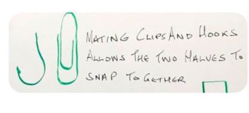

Tip number two: use self-mating parts.
Take the housing we were just talking about – it’s nice and symmetrical, but it still requires manual installation of threaded inserts, never mind keeping track of all the screws and washers. Too much hassle by half.
multi part assembly insights
Instead, you can use a simple system of mating clips and hooks and allows the two halves to snap together. You can take things even further by replacing even the clip mechanisms with a living hinge; now you have a single-piece design.
The amount of materials you need has been slashed, assembly time is cut to zero and you just need one mould. Can’t really ask for more.
