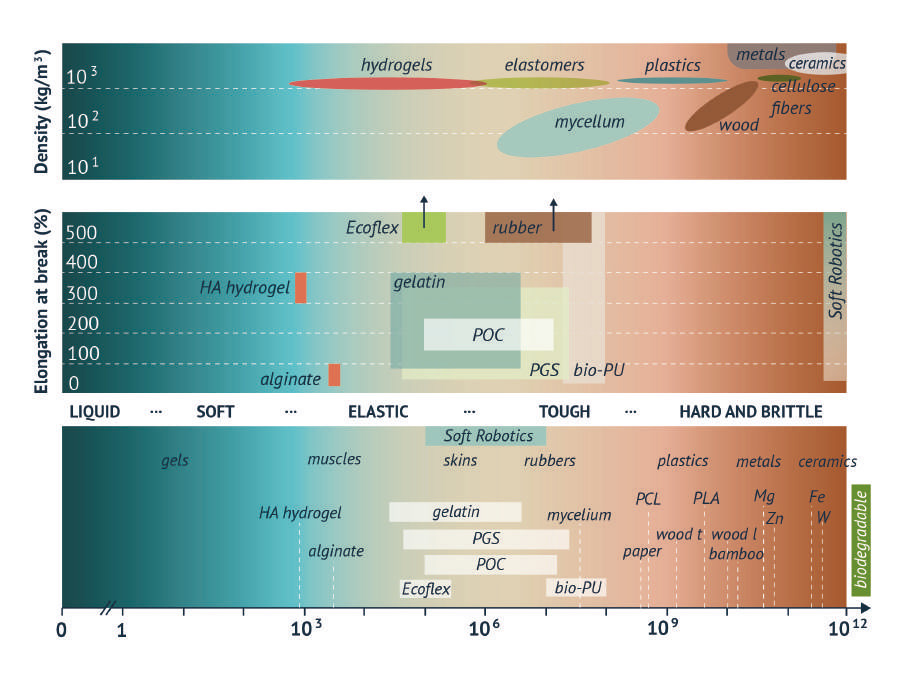

Compared to traditional robotics, soft robotics is based on a new generation of deformable, flexible, and smart materials. One of the main classes of soft robotics materials is elastomeric materials, such as natural and synthetic ubbers, silicones, like polydimethylsiloxane (PDMS), and soft composites.
Elastomers are mechanically compliant and have high elastic modulus so that they can recover their shape even after very significant deformations.[5]
The first fully autonomous soft robot was designed in 2016 and featured an elastomer-based body.[7]
This robot, called “Octobot” from its octopus-inspired shape, is controlled by microfluidic logic and actuated by a gas-producing chemical reaction. It is actuated by an Embedded Pneumatic Network (EPN) that exploits the ability of elastomers to expand without breaking when gas is released.
The main advantage of using elastomers compared to rigid materials for robotics is the possibility of movement in limited space and the ability to distribute impact loads more effectively across the entire robot body.
Another class of evolving robotics materials is smart materials. These materials are intrinsically multifunctional, combining sensing, actuation, and structural purposes in a single component. Smart materials can change their shape in response to several stimuli including electric fields, temperature, light, and pH.[3]
Among smart materials, electromechanically active polymers (EAPs), also known as artificial muscles, are deformed in response to applied voltages. In soft robotics, they are used to produce actuators by sandwiching the polymer between two compliant electrodes.[8] Shape-memory polymers, on the other hand, are programmed to recover a specific shape upon heating. These have interesting applications in the aerospace and biomedical fields.[3]

The field of soft robotics extends the versatility of end effectors by replacing rigid components with softer and more flexible end effectors. Soft robotics mimics biological qualities, which may improve a robot’s ability to manipulate fragile or pliable objects. Minimising rigid surfaces on the robot may also reduce safety hazards for robot operators.

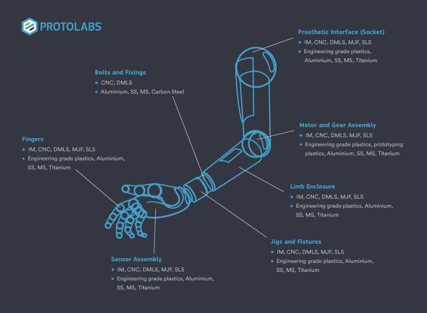

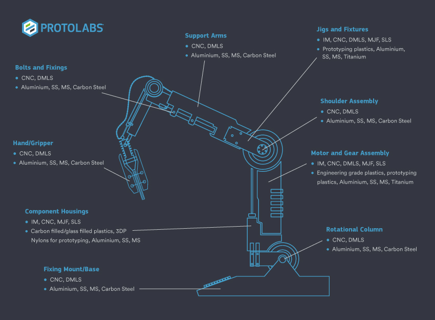

3D printing can be particularly useful in the the design and manufacture of cameras, motors, sensors, microcontrollers, manipulators, and robotic arms. Further discussed in the materials section, the materials available for 3D printing are expanding. Once limited to a narrow range of plastics, 3D printing is now available in metals, ceramics, and flexible materials.
CNC machining, which includes both milling and turning, is a valuable manufacturing process for robotics development and end manufacturing. Ideal for prototyping and low volume production, automated CNC machines enable robotics developers to order and receive parts, sometimes within just days. CNC also offers tighter tolerances than other services, and its 5-axis process provides high complexity and variation, important for applications that demand precise, repeatable movements. Finally, the service allows for controlled surface finishes, which are needed for low-friction components in interactive parts. These aspects make CNC machining perfect for the highly customised parts at low volumes that robotics often requires.
Why CNC machining for the Robotics industry?
- Precision parts (important as parts need to fit together perfectly - critical for the proper function of a robot)
- Strong, durable materials
- Can be used to create complex shapes - allows for greater design flexibility
- Fast and efficient
- Surface finishes - good for low friction parts required for interacting
- CNC machining is a good fit for the manufacture of gears, end effectors, custom fixtures, motor and components among others.
