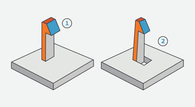

Overmoulding Material Bonding
Chemical bonding between overmoulded materials is possible, but material compatibility should be considered in order to achieve desired bond strength. Incorporation of an adequate mechanical bond is strongly recommended if bonding is critical to your application. An undercut is a good example of a mechanical bond.
Substrate Material
Overmould Material ABS POLYLAC PA-717C ABS/PC BAYBLEND T65 XF PC MAKROLON 2458 PBT CELANEX 2002-2 PP MOPLEN RP348R NYLON 66 ZYTEL 70G30HSLR
TPU Pearlthane 11T85 C C C C M M
TPV Sarlink 3170 M M M M C M
TPE Thermolast K TC6 MLZ C C C M M M
LSR Elastosil 3003/30 AB/B - - M M - M
TPC Hytrel 4068FG C C C C M M
M = mechanical bond (recommended)
C = chemical bond

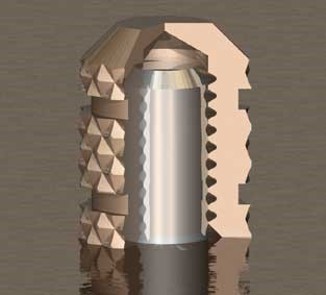

Insert Moulding for threading
Instead of a mould that produces a final part using two separate shots like overmoulding, insert moulding generally consists of a preformed part—often metal—that is loaded into a mould, where it is then overmoulded with plastic to create a part with improved functional or mechanical properties.
One way insert moulding is used is with threaded inserts, which reinforce the mechanical properties of plastic parts’ ability to be fastened together, especially over repeated assembly. Bushings and sleeves are another great way to increase part durability for mating components that need more abrasion resistance due to moving parts.

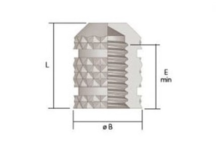

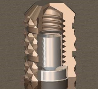

Type A
Size Pitch Diameter External 'B' Length 'L' Bolg Engagement 'E' No. of Full Threads Counterbore 'S' Type Part Number
M3 0.50 4.15 6.40 3.70 6.80 X A 116M3
M3.5 0.60 5.00 7.90 4.90 7.60 X A 116M3.5
M4 0.70 5.90 8.70 5.45 7.00 X A 116M4
M5 0.80 6.60 9.50 6.45 7.00 X A 116M5
M6 1.00 10.00 12.50 8.30 7.50 X A 116M6
Currently we are only providing threaded brass inserts within a defined range as Protolabs supplied inserts. Contact us if you require the CAD model of any of these inserts on +44 (0) 1952 683047 or email customerservice@protolabs.co.uk
tappex insert type A
images courtesy of tappex.co.uk

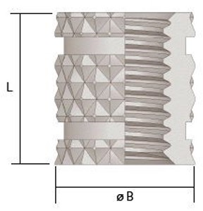

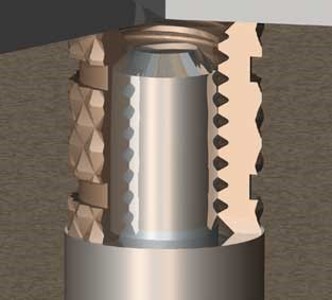

Type B
M2 0.40 3.40 3.925 X X X B 017M2
M2.5 0.45 4.15 4.725 X X X B 017M2.5
M3 0.50 4.15 4.725 X X X B 117M3
M3.5 0.60 5.00 5.875 X X X B 117M3.5
M4 0.70 5.90 7.125 X X X B 117M4
M5 0.80 6.60 7.825 X X X B 117M5
M6 1.00 9.25 9.925 X X X B 117M6
tappex insert type B

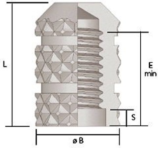

Type C
M2 0.40 3.40 5.60 3.75 6.30 0.85 C 018M2
M2.5 0.45 4.15 6.50 4.10 6.00 0.95 C 018M2.5
M3 0.50 4.60 7.45 4.75 6.30 1.10 C 118M3
M3.5 0.60 5.00 9.30 6.25 7.20 1.35 C 118M3.5
M4 0.70 5.90 10.30 7.05 6.80 1.60 C 118M4
M5 0.80 6.60 11.30 8.35 6.70 1.75 C 118M5
M6 1.00 10.00 14.50 10.35 7.00 1.85 C 118M6
tappex insert type C
images courtesy tappex.co.uk

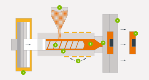

How do overmoulding and insert moulding work?
how do overmoulding and insert moulding work
From left to right, the components of an overmoulding press include: ram (1), screw (2), hopper (3), barrel (4), heaters (5), materials (6), nozzle (7), overmould tooling (8), and overmoulded part (9).
With overmoulding, the production of the substrate parts is a standard injection moulding process involving an aluminium mould with no heating or cooling lines running through it. Cycle times are a bit longer, which allows our moulders to monitor fill pressure, cosmetic concerns, and the basic quality of the parts.
When the total run of substrate parts are moulded, overmould tooling is then assembled to the press. The substrate parts are placed by hand into mould where each part is overmoulded with either a thermoplastic or liquid silicone rubber material.
Insert moulding is a similar process but instead uses a preformed part—often metal—that is loaded into a mould where it is then overmoulded with plastic to create a final component. When the run is complete, parts are boxed and shipped shortly thereafter.
