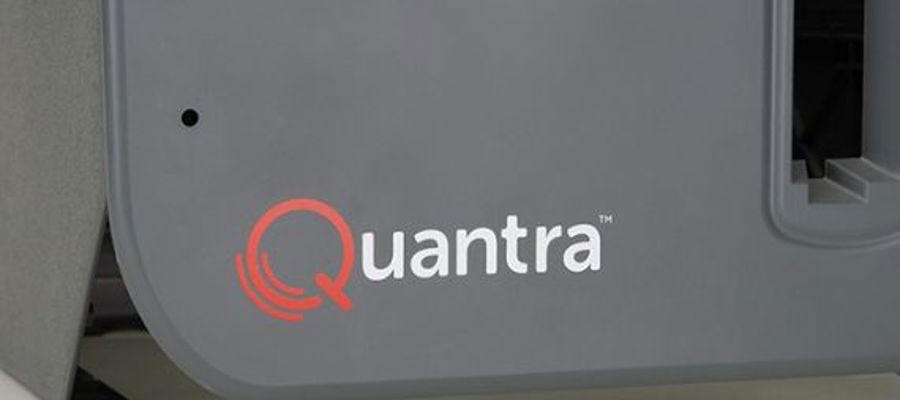

Industrial Pad Printing (also known as tampography or tampo printing) is a printing process that transfers a 2D image onto a 3D object by using a silicone pad to transfer the image onto virtually any shaped surface.
From a simple single colour digit on a medical instrument, through to a 4-colour image on a consumer electronics housing (such as a brandname or logo).
Due to the silicone pad having unique properties, it is able to pick up the image from a flat surface and transfer it on to a variety of surfaces including: flat spherical, cylindrical, textured, concave and convex

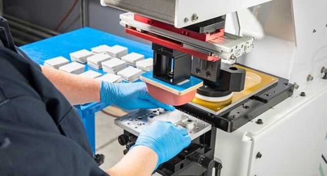

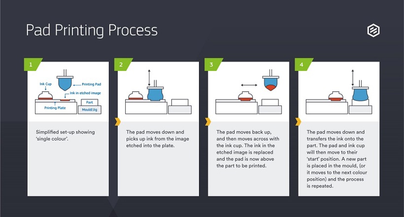

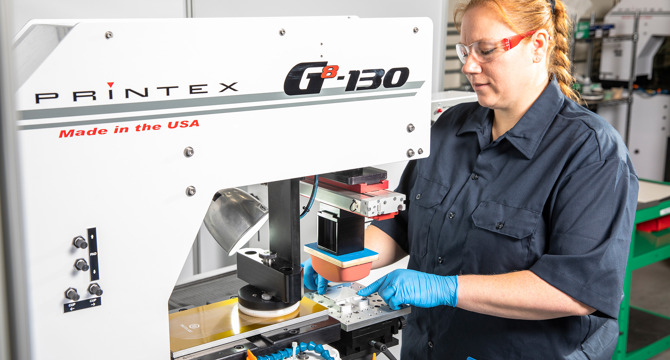

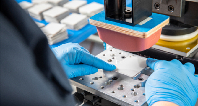

How does Pad Printing Work?
The sealed ink cup sits over the engraved artwork area of the printing plate. The image is covered and filled with ink. The cup moves away taking any excess ink and exposing the ink filled image to the air. The top layer becomes tacky, the pad presses down onto the printing plate. During compression, air pushed away, resulting in the transfer of the ink (from the plate to the pad). The pad lifts taking the inked image, leaving behind a small amount of ink on the printing plate. The print pad moves to compress down onto the part transferring the ink from pad to part surface as the ink cup refills ready for the next cycle. The pad lifts and returns back to the original position to start again.
