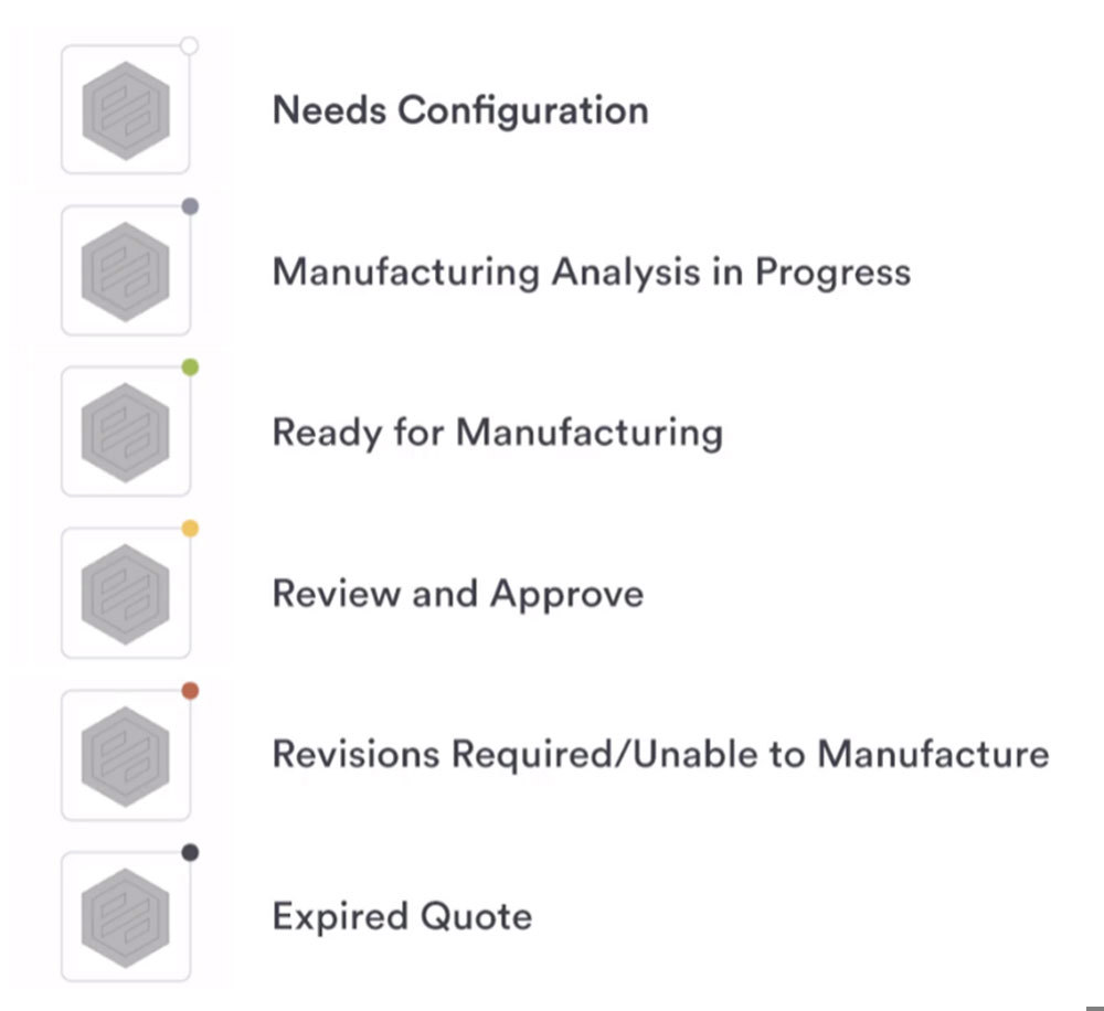

Interpreting Color Indicators
In some cases your design may require changes, noted by color-coded statuses throughout the process

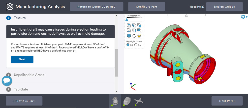

Common Advisories
  • Part Exceeds Limitations
  • Thin and Thick Areas and Walls
  • Zero Draft
  • Texture

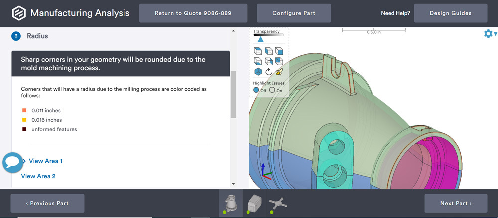

  • Radius

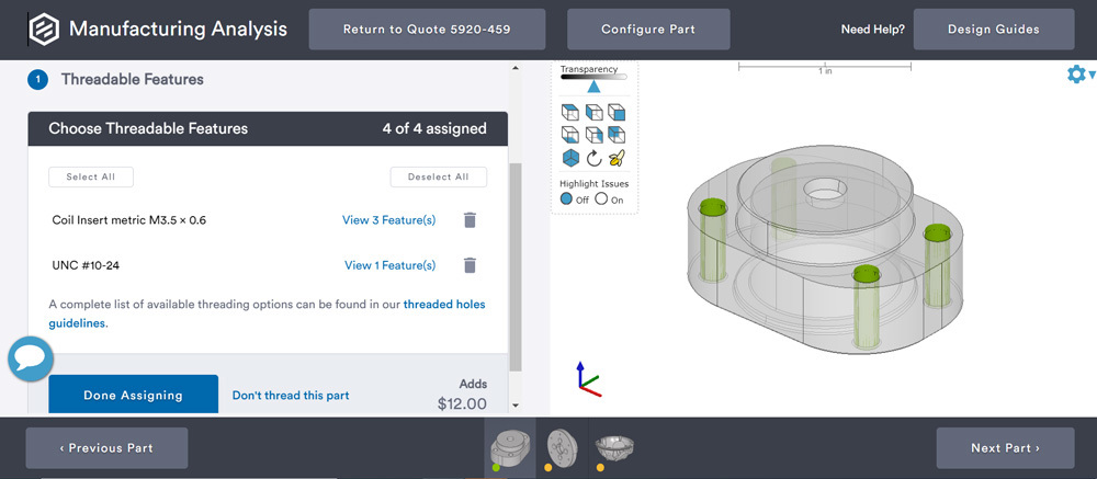

CNC Machining: Threaded Features
  • Easily highlight and assign which holes need threads by clicking on 3D model (vs. choosing from list of holes)
  • Immediately see the cost implications
  • Limited selection of UNF, UNC, and metric threads along with coil and key inserts

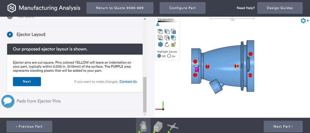

Molding: Gate & Ejector Pin Layout
  • A gate and ejector pin layout design review on molded parts directly within your manufacturing analysis is now available before you place your order. Within your manufacturing analysis, you’ll be prompted to view Gate & Ejector Layout
  • Yellow and red indicate where it will be gated along with specific notes detailing the type of gate used where a small vestige may occur on the surface. Comment by clicking on a section of your 3D model or advance to the next step, which is your ejector pin placement.
  • Yellow circles indicate where pins will be used to eject your parts from the mold. Comment on our recommended pin placement, which will be sent back to our team, or continue toward approval.
  • Finally, you can download a PDF design review to look over and check the approval box.

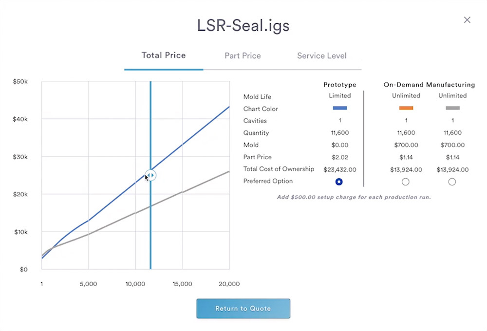

Molding: Tooling Options
  • When requesting a quote, you’ll have the opportunity to choose the mold life of your tooling—limited or unlimited. Or choose I’ll Decide Later and we’ll work with you to identify the best tooling option.
  • With unlimited, you’ll move into our on-demand manufacturing (ODM) option where you can also select sample quantity and identify whether you’ll need a single-cavity mold or multi-cavity mold (up to 8 cavities).
  • Our Price Curve Tool compares tooling options to give you full visibility and total cost of ownership on molded parts.
