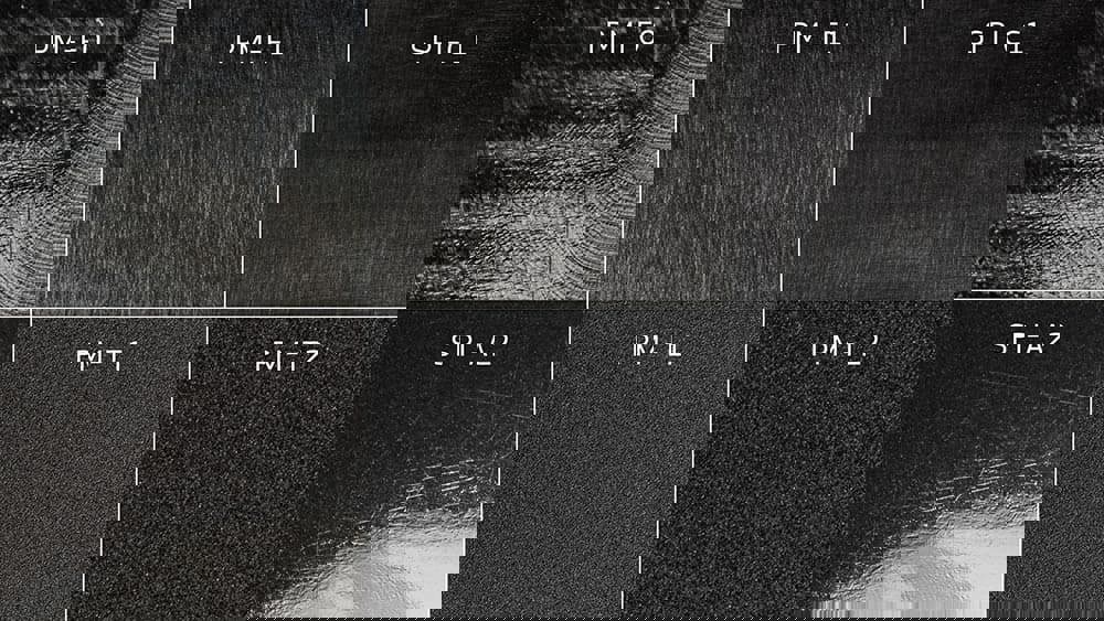

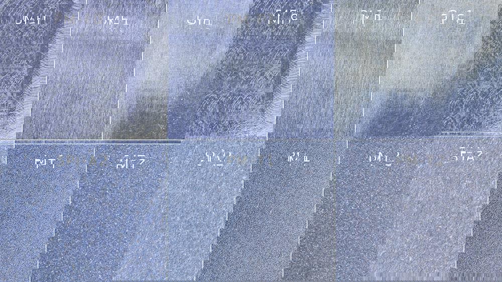

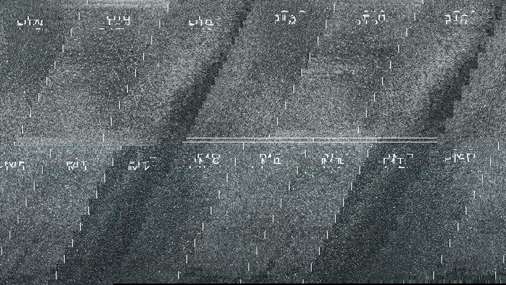

All polish and texture is applied directly to the mold itself and transferred to the parts during the injection molding process. For this reason, secondary finishing is not available, which makes material selection critical in some cases. Typically, the link between the surface finish and material is small, but glass, mineral, or soft and high-shrink materials can produce parts that don’t always reflect what you may be looking for in a finish.
Below are images depicting each surface finish option for injection molding.

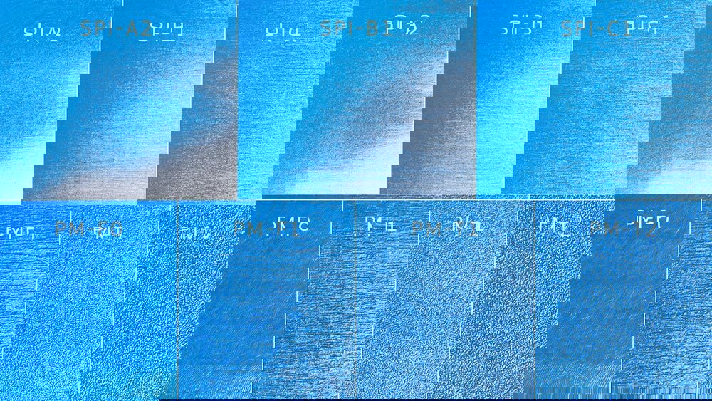

At Protolabs, aluminum molds can be quickly produced by three-axis milling and hand polished or textured to one of eight surface finishes. Two examples of these finishes include PM-F0, left, which is a non-cosmetic finish used when a polish is unnecessary and an as-milled appearance is acceptable; and SPI-C1, right, a 600 grit stone polish that removes tool marks but is still not a high-end fine polish.

Other examples of surface finishes available from Protolabs include SPI-A2, left, which is a Grade #2 Diamond Buff, providing a high-end fine polish, when the cosmetic appearance of a part is important; and PM-T2, right, which provides a medium bead blast textured finish.
