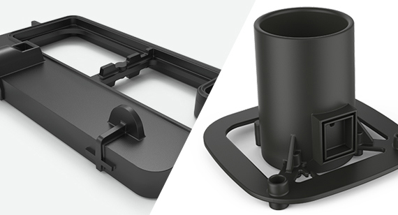

Injection molded part
A prime benefit of injection molding is having hundreds of material choices (Lexan 940 part pictured), including a range of alternative material options to choose from during supply shortages.

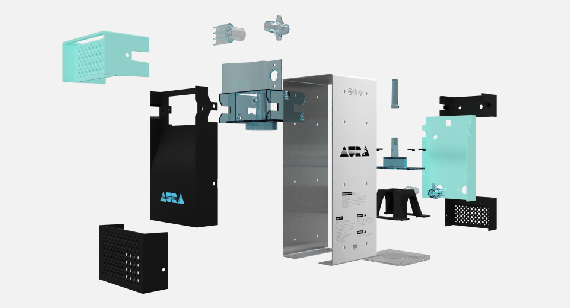

Aura Ventilator exploded view
The Aura Project moved from our 3D printing and sheet metal services for prototypes to injection molding for production for its Aura Ventilator, created during the pandemic last year.
