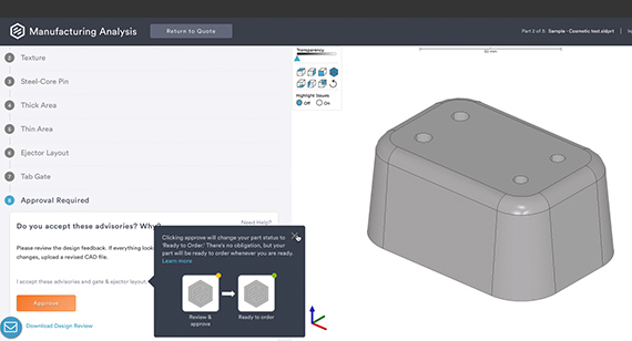

But hey, in some cases, your design may have no critical manufacturability issues. No required changes. Not even any suggested changes. You nailed it. Nice work. In other instances, you may need to make some tweaks. Your parts will have many color-coded statuses as they progress through the configuration, analysis, review, and approval stages. Ultimately, the goal is to get your parts to green Ready to Manufacture status. Here’s how the colors translate:
- White = Needs Configuration. All newly uploaded parts begin with a white status. These parts need to be configured and, if necessary, sent for analysis.
- Gray = Manufacturing Analysis in Progress. Parts with a gray status are currently being analyzed by our team to identify manufacturing limitations, lead times, and pricing. You'll get an email from us when all the parts on your quote are ready for review.
- Green = Ready for Manufacturing. Parts have completed analysis and quoting, and do not require additional review or approval. You may checkout once all parts on a quote have reached this status.
- Yellow = Review and Approve. Parts with a yellow status are almost ready for manufacturing. We just need you to review the manufacturing analysis to approve advisories, accept gate and ejector layouts, and/or choose your threading options. Once approved, your parts will change to green status.
- Red = Revisions Required/Unable to Manufacture. Unfortunately, we are unable to manufacture parts with a red status. Please review the manufacturing analysis to learn how you may modify your part design to match our manufacturing capabilities. You can also contact us to review with one of our application engineers.
- Black = Expired Quote. Parts with a black status have expired pricing. Please resend for quoting. Thanks!
We look at many variables and, depending on the manufacturing service you’re using, highlight features that are potentially troublesome. On any recommended changes, you’ll need to adjust your design to improve manufacturability, or accept any limitations to the part that may occur if changes aren’t addressed. Any required changes means you’ll need to update your part geometry based on the feedback and upload a new CAD file to proceed with your order.

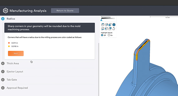

Radius. Adding radii—an edge or vertex that has been rounded—is typically a natural element of the milling process, whether a mold is being milled or an actual part is being machined. In your manufacturing analysis, we’ll highlight on your 3D model where these radii will occur. In some cases with injection molding, we’ll add radii to assist with the flow of thermoplastic resin through the mold. Radii are less of a concern with additive manufacturing, however, if you plan on producing larger quantities of molded parts from that same 3D-printed design, it’s something to keep in mind.

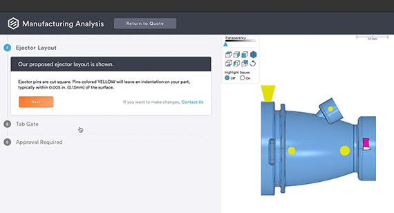

Gate & Ejector Pin Layout for Injection Molding
We’ve now built your gate and ejector pin layout design review on molded parts directly within your manufacturing analysis before you place your order! In our prior platform, this could be a time-intensive back-and-forth conversation whereas now it’s streamlined directly within your quote. Again, the goal is to make this as painless as possible for you to order parts.
Within your manufacturing analysis, you’ll be prompted to VIEW GATE & EJECTOR LAYOUT. In doing so, we’ll highlight on your 3D model in yellow and red where it will be gated along with specific notes on the left side of the screen detailing the type of gate used—sprue or tab gate, for example—and that a small vestige typically may occur on the surface. You can comment on the layout by clicking on a section of your 3D model or advance to the next step, which is your ejector pin placement.
Here, we highlight in yellow circles all of the areas on you 3D model where pins will be used to eject your parts from the mold. Note that ejector pins typically leave small indentations on the surface your parts of approximately. Again, you can leave a comment on our recommended pin placement, or continue toward approval. Finally, you can download a PDF design review to look over, check the approval box, and you’re all set. If you’ve left any comments, those will be sent back to our team for review and to prepare a revised layout based on the feedback.

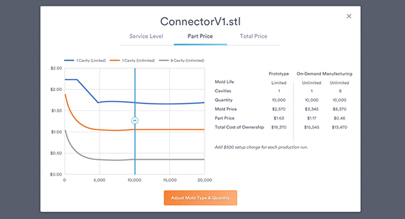

On-Demand Manufacturing for Low-Volume Injection Molding
We provide two injection molding service options. One is best suited for those who need smaller part quantities often associated with prototyping and the other a good fit for those who require larger part quantities common in low-volume production called On-Demand Manufacturing (ODM). While the molds themselves are similar, part quantities, lifetime maintenance, quality documentation, and pricing vary depending on which service option is chosen. The right one depends on your project needs. Let’s quickly look at the benefits of ODM and how to select that option it in your quote.
When requesting a quote, you’ll have the opportunity to choose the Mold Life of your tooling—limited or unlimited. You can even choose I’ll Decide Later and we’ll work with you to identify the best tooling option. By selecting unlimited, you’ll move into our ODM option. From there you can also select Sample Quantity and can identify whether you’ll need a single-cavity mold or multi-cavity (up to 8 cavities).
To help you decide, we created an all-new Price Curve tool that compares prototyping against ODM options so you have full visibility and total cost of ownership on molded parts throughout the product life cycle. As you adjust the total quantity you’ll see in real-time the impact on cost. And because of the cost saving at higher volumes, ODM is suitable for ramping up before shifting to full production volumes (outside of Protolabs). Additionally, a range of secondary services help provide a more comprehensive on-demand manufacturing service.
