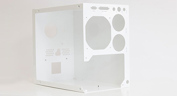

Hardware product prototyping allows companies to find and fix technical challenges and gives a better understanding of how end-users interact with their product in real environments. It also suggests how a product fits into the market. For example, excessive temperatures are not ideal for operating electronics. A working prototype may find that the hardware is trapping heat, or there is a hot spot on a printed circuit board (PCB). Changing the hardware design to include vents might solve the problem. With access to rapid prototyping and digital manufacturing using CNC machining, injection molding, 3D printing, and sheet metal fabrication, companies can move quickly from one iteration to another with limited production runs.
![computer chassis manufactured with sheet metal process](/media/j0njqznh/computer-chassis-manufactured-with-sheet-metal-process_580x308.jpg?width=570&height=308&rnd=133083968646200000)
