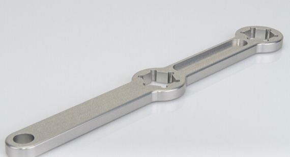

Anodizing provides corrosion protection
Beyond corrosion protection, anodizing enhances the overall appearance of metal parts.
What is Anodizing?
Let’s use aluminum as an example. Chemically speaking, aluminum is the kind of material that wants to attract electrons in order to reach a totally stable molecular state when combined with other elements. In the anodizing process, the aluminum is placed in an acid bath. Electricity is run between the metal, which acts as a positively charged anode (thus, the name anodizing) and the oxygen-rich acid bath. The oxygen in the acid tends to become negatively charged in this environment. Within the electrical circuit, opposites attract and oxygen bonds with the aluminum, forming a much thicker protective layer of aluminum oxide on the surface, which gives your parts wear and corrosion protection. While no metal is entirely safe in an environment exposed to the elements, of course, anodizing metal does provide effective defense against corrosion.
Beyond corrosion protection, anodizing enhances the appearance of aluminum for cosmetic applications, giving your parts a chance to shine with a colorful surface finish. That surface is actually quite porous. That means we can dye the material. The quality of the metal still shines through, but it now has a colorful, metallic luster.
A great example is the rugged little metal flashlight you probably have in your home toolbox that came in a huge array of colors. After the dye is applied, a sealer helps close up those pores. In the end, you will likely replace dozens of batteries before ever seeing your flashlight show any signs of corrosion.
