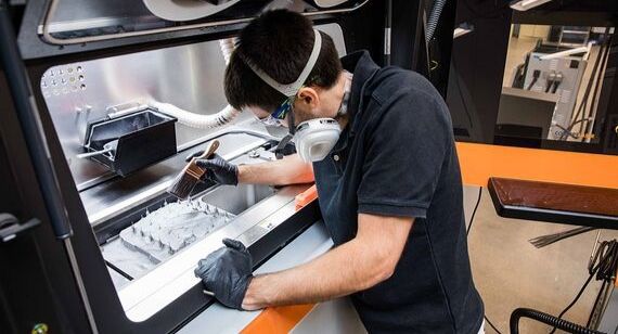

3D Printing Options for Jigs, Fixtures
Beyond machining, industrial-grade 3D printing can also be a viable option for jigs and fixtures, and, again, both in metal or plastic. This is especially the case when the geometry is too difficult or costly to machine. The key is choosing which technology fits better for a particular application.
The general rule is: if it can be 3-axis CNC machined, it should be machined. Machined fixtures usually have superior surface finishes, stronger materials, and greater accuracy. Also, for lower volume runs, costs and turnaround times are about the same as 3D printing.
As mentioned, 3D printing comes in to play when jigs and fixtures have irregular or complex shapers or are smaller than usual. In addition, when producing multiple jigs and fixtures, 3D printing can be a good way to keep costs down.
One of our recent design tips outlines which of our 3D printing processes fits best for particular jig/fixtures applications.
For plastic jigs and fixtures, stereolithography (SL) is a popular option for building smaller, complex jigs and fixtures, because of the excellent surface finish possible on final components. Selective laser sintering (SLS) is used more regularly for larger jigs and fixtures, producing durable and accurate pieces that are stronger than those made with SL. SLS also offers a larger build volume but parts will have a rough finish and lack finer details. Multi Jet Fusion is also becoming increasingly popular for producing jigs and fixtures—producing functional nylon prototypes and end-use production parts in as little as a day.
For 3D printing metal jigs and fixtures, direct metal laser sintering (DMLS) can produce extremely durable items. DMLS surfaces, though, tend to be rough and turnaround times are longer because of post-processing requirements.
