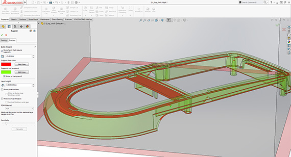

SOLIDWORKS can check your designs for all of these things so you know any features likely to have undesirable results. To run these checks, go to File > Print3D. You’ll find it beneath the 2D print option.
In order to run the checks, you need to enter the build envelope size of your printer, or the printer you are going to use so you know it fits. You also need to choose the build orientation. Then to check the manufacturability, go to the Preview Tab. On the Preview tab, you can highlight any faces requiring support material. Using the Show as Transparent option makes it easier to see those faces without rotating to a bottom-up view.
Thickness/Gap Analysis
The most important check for additive manufacturing is the Thickness/Gap analysis. Built into SOLIDWORKS are some recommended values for the FDM process based on the layer thickness the printer is set to. For all other processes, check the Custom thickness and gap box and enter the minimum thickness/gap that is achievable by the process you are going to use.
Thin walls are highlighted with orange arrows and thin gaps with blue ones. These checks are particularly useful when you have scaled down the part as it is easy to overlook the fact that walls thickness reduces by the scale amount.
