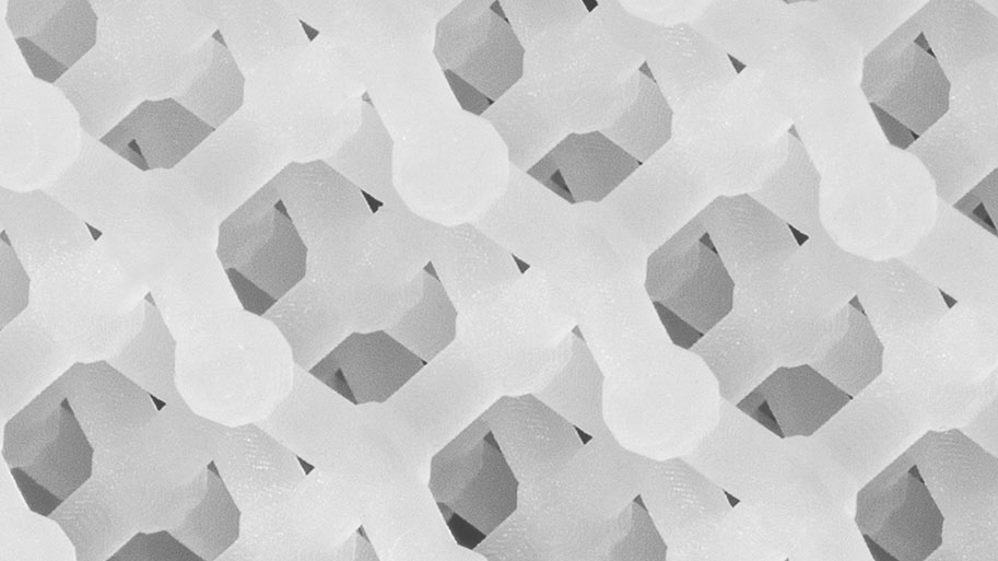

![Zoomed in on molecular bonds](/media/xo1njr1i/sla_truesilicone_2022_lattice_002_lr.jpg)
The molecular structure of 3D-printed silicone parts, like the one in the image above, share the same mechanical properties as LSR molded parts.
