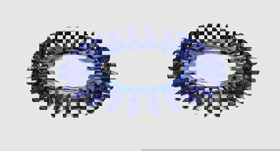

![Glass-filled plastic part](/media/1020020/thermoplastic-additives-image1-new.jpg?width=570&height=308&rnd=132322040509570000)
