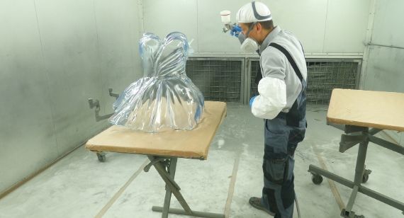

In coordination with GE Additive, we used stereolithography (SLA) to bring Zac’s visions to life for a shoulder piece, a clear bustier that actress Nina Dobrev wore, and embroidery components. We manufactured a headpiece using Multi Jet Fusion (MJF) to ensure high-quality details and strength.

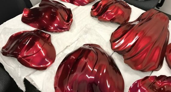

Everyone knew that the collection’s tour de force was Zac’s 3D-printed rose gown, worn by model Jourdan Dunn. We used a large SLA printer to create 21 unique flower petals, each weighing 1 lb. (0.4536 kg). Early in the process, we started to realize that the dress might be excessively heavy. After some discussion, our teams determined that simply removing a layer of plastic equal to the thickness of a sheet of paper from all of the petals would shave 1 lb. off the dress. So we adjusted the designs accordingly. We mounted the petals onto a strong, but lightweight titanium (Ti-64) frame, which isn’t visible. It was 3D printed, too, but using electron beam melting (EBM) technology. In all, the well-balanced gown weighed 30 lbs. (13.6 kg) and it took more than 1,100 hours to print and finish it.
Zac’s whimsical designs flow, breathing life into rigid plastics. The seemingly delicate rose petals (made using the rugged polymer, Accura Xtreme White 200) appear to float on air, filled with natural curves and shadows. The bustier’s shape captures a moment in time when its ties have been blown backward in a strong wind—a story unto itself. In consultation with GE Additive, we chose a strong, clear, ABS-like polymer to ensure transparency.
