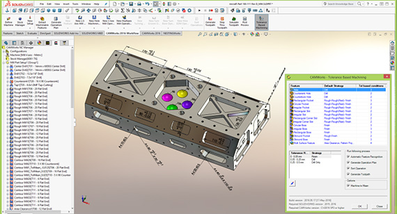

MBD can also improve manufacturing efficiencies. For example, in a conventional way of Computer-Aid Manufacturing (CAM), a manufacturing engineer programs based on a model directly, but he or she has to read separate drawings to exact the tolerances and surface finishes, and then go back to the model and manually type in these requirements into the CAM program. The back-and-forth switching between models and drawings not only slows down the process, it also introduces potential human reading or typing errors.
In contrast, in a model-based environment, you can read everything in one place as shown in Figure 3 without having to switch back and forth between different documents. The models and requirements in annotations are integrated for easier reading.
Furthermore, the tolerances and surface finishes can be consumed and acted upon by the SOLIDWORKS CAM software so that you don’t have to manually read or type them. In other words, these intelligent annotations can automate the Numeric Control (NC) code programming one step further than the model itself.

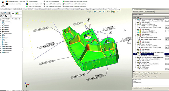

What about inspection? Acting upon 3D geometric dimensioning and tolerancing (GD&T), CheckMate can automatically program coordinate measuring machine (CMM) paths and soft gauges. Plus, the CMM sample points or a 3D-scanned point cloud can be overlaid on top of and compared with the nominal CAD model. Then, CheckMate automatically generates a quality heat map per the intelligent 3D GD&T as shown in Figure 4.
