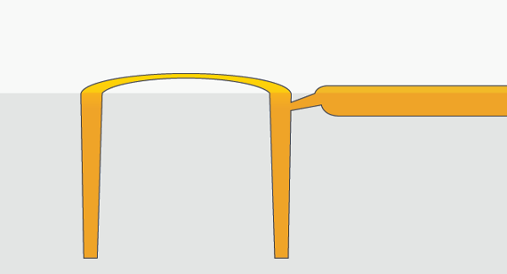

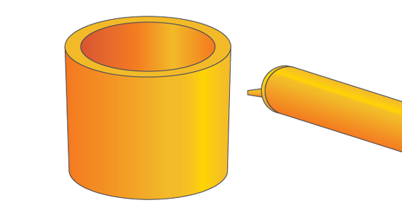

What is a Tunnel Gate?
A tunnel gate is a type of molding gate that is machined at an angle and below the parting line of the mold, such that the part is automatically sheared from the runner (which, as mentioned, delivers resin to the mold cavity) at the time of part ejection. Accordingly, because the runner is cut from the part as part of the ejection process, there is no need to manually trim the gating system from the part itself.
