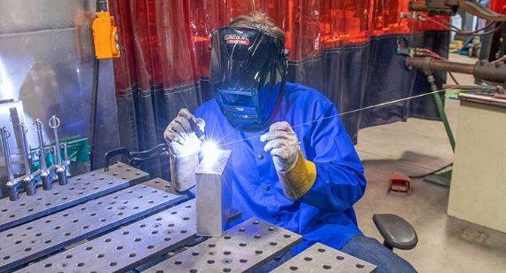

Welding for Sheet Metal Fabrication
Welding is one of the most common methods for joining or fusing sheet metal and is a critical design feature. However, it can be a drag on price due to the amount of time and training it requires, especially depending on the chosen weld location, type, and part functionality.
Fillet, tack, and stitch welds are the most common types of welds available for sheet metal fabrication. Fillet welds are often pricier because they require a precise, continuous bead that joins two pieces of metal together. If you are working on a prototype part that will have a long fillet weld, you may consider using a stitch weld while you verify your design—it will do what you need (join two pieces together) without such a high price tag. It’s also important to note that extensive fillet welding may have an impact on part design and tolerances due to excessive heat.
Welding vs. Riveting: Which is Best? |
Welding and riveting both offer advantages and limitations depending on your sheet metal part and available budget for your project. Learn more in our blog post, where we break down the differences between the two to optimize your part design. |
Complex welds can also increase per part metal fabrication cost significantly. Fusing corners together with welding, for instance, could be more cost prohibitive than choosing rivets, which can be just as effective as joining two pieces together.
Welding thinner sheet metal parts (less than 1mm or .039 in. thick) also brings some risk in to the equation, as it can distort the material due to the extreme heat. In this case, riveting can be a more cost-efficient solution, while also ensuring a higher quality sheet metal part in the process. Riveting does have its own cost considerations as well.
