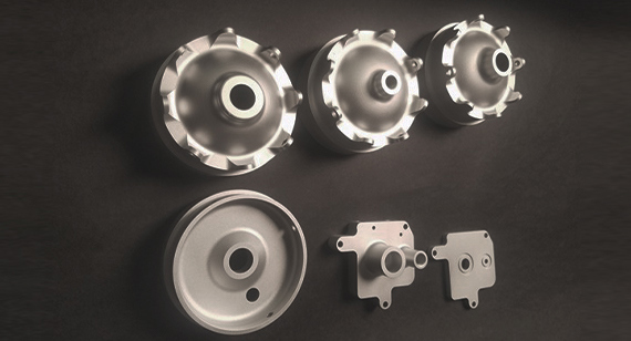

Did an applications engineers help during the process?
The Protolabs applications engineers guided our team to maximize the benefits of their automated machining by helping us design for the company’s toolset. Protolabs’ engineers gave us clear and quick feedback as to what features could and could not be manufactured, allowing us to iterate rapidly to produce parts that worked.
Specifically, small radii of curvature needed to be increased to allow machining tools to properly create them. Tapped holes could only be manufactured up to a certain size, so we modified a few features that would allow us to machine the holes after we received the parts.
What parts did Protolabs manufacture for you, and what service and materials were used?
We manufactured three parts with Protolabs: propellant tank domes, one propellant tank bulkhead, and two pyrotechnic valve housing parts—all of which were CNC machined.
Each part was made with aluminum 6061-T6. We chose aluminum for its high strength-to-weight ratio, higher than steel, and its low cost. The particular alloy used is a moderately-strong alloy and weldable. Weldability was critical for the propellant tank domes, which will be welded to cylinders to produce the completed propellant tank.
