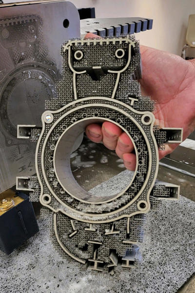

![EDM cutting part](/media/4w1jqxjf/cut-1.jpg?width=400&height=600&rnd=133132485595700000)
Removing Printed Parts from Build Plates
Let’s face it: Cutting off a build plate is one of the most boring and overlooked parts of the metal 3D printing process, but it’s critically important that it be done quickly and efficiently the first time so it doesn’t add unneeded costs. This seemingly simple process has become increasingly challenging in recent years. Printers are faster than ever, but they are printing parts in materials that are harder and harder to cut from the build platforms. Sometimes, build platform sizes are too large for readily available cutoff methods. We identified this pending problem and began searching for a better solution for the issue, which came in the form of EDM Performance Accessories’ HB series molybdenum wire EDMs. EDM stands for electrical discharge machining, and goes by other names, such as spark machining, spark eroding, die sinking, wire burning, or wire erosion. EDM erodes materials using repetitive sparks between the platform and the molybdenum wire in contact with a dielectric fluid.

After size and capacity, we had to consider speed and cost. Our goal is to provide customers with quick-turn prototypes and end-use parts at price points most small or large companies can use. To assess cutting speed, we compared a traditional challenging part on both our existing brass wire EDM machine and our HB series EDM. The brass EDM averaged a 7-8 hour cut off time on this steel valve body. This part had many small support pieces that could break loose during cutting, causing wire breaks and delays. It also has large variations in cut thickness. These are less than ideal conditions for efficient EDM cutting. Fast wire molybdenum EDM, however, works using a much different method than brass EDM. The wire runs at nearly 40 feet (12.2m) per second on the HB machine creating a “flushing” effect through the part to speed material removal. The wire has double the tensile strength and nearly 3x the melting point of brass EDM wire, too. These two features allowed for a completely error-proof cutoff and no loss in speed or delays from breaks. In the end, the molybdenum EDM shaved off six hours of processing time.
![stainless steel DMLS part](/media/luhpbbdm/cut-4.jpg)
This entire cut of a stainless steel DMLS part from the build platform was achieved in only 44 minutes.
