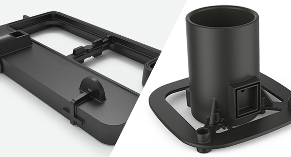

Lexan 940 is Prime Polycarbonate for Injection Molding
Today, Lexan 940 resin continues to impress as a staple polycarbonate (PC) used for injection molding. Often, you’ll find it used in cosmetic parts, such as consumer electronic housings and handheld devices. You’ll also see it in aerospace applications, appliances, and in the lighting industry as lenses and reflectors.
