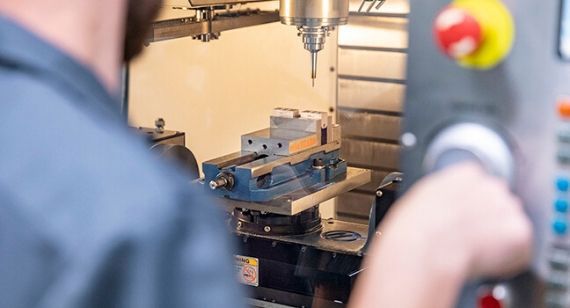

CNC machining
CNC machining processes, which include milling (seen here at a Protolabs facility) and turning, can produce parts swiftly, and so are used for rapid prototyping and low-volume production.

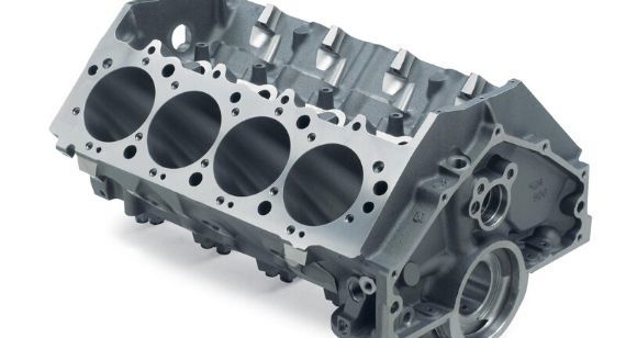

  • Traditional sand casting is a bit cruder than die casting. Surface finishes are granular and mismatches between mold halves and inserts can require post-processing due to loose tolerances in the casting. The process is used for non-cosmetic parts such as engine blocks for automobiles. Difficult high-volume applications such as creating engine coolant channels around cylinders often require post machining to finish the part. Some design solutions in sand casting can’t be replicated in die or CNC machining.
  • CNC machining is typically used for lower volumes, think dozens to a few thousands. It is quick and responsive and doesn’t require preparatory tooling the way casting methods do. In addition to low-volume production, it can be used to create prototypes of die-cast or sand-cast parts until a final design is created and tooling can begin. It can also be used for bridge tooling to create production parts while tooling is produced for high-volume production.

casting
Casting is used for high-volume, non-cosmetic parts such as engine blocks for automobiles, as seen here. Photo: Summitracing.com

There are situations in which the choice of process is obvious. If you are producing a high volume of parts, think tens of thousands and beyond, casting is far more economical. Producing the die takes time, but each cast part can be produced quickly and at relatively low incremental cost.
CNC machining, on the other hand, produces the first parts much more quickly and economically, but there isn’t as much of an economy of scale after a certain point.
As a result, the first consideration in choosing a manufacturing method is volume. If you need dozens for prototyping or hundreds or a few thousand for low-volume, end-use production, then you should consider machining. For 10,000 or more, consider sand or die casting. Between those extremes, however, a variety of factors can influence your choice.
