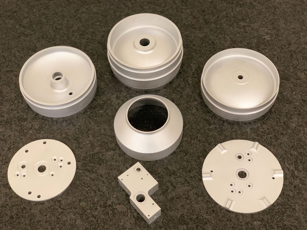

Reducing Cost and Mass with Machined Aluminum Components
They began work on the new design by modifying the propellant tank endcaps. The previous endcap design was spherical and while it worked well, the team discovered that by changing it to be elliptical, they could reduce manufacturing costs and after some structural optimization reduce the mass of the component as well.
Another major design change was made to the propellant tanks. Normally a rocket will have two propellant tanks, but to save mass, they created what is called a common dome design. To do this, they completely redesigned the flow path between the tanks and pyrotechnic valve using custom parts with internal volumes. The common dome saved .3 pounds in weight, and while that may not sound like much, any reduction in weight correlates to a proportional increase in altitude (i.e. a 10-percent decrease in mass will result in a 10-percent increase in altitude). Each part was machined from 7075 aluminum, which was chosen for its excellent strength-to-weight ratio.
The team of students used the design analysis provided in each CNC machining quote to further optimize the geometry for the manufacturing process and find ways to save costs. Since the design feedback in each quote is automated, they could iterate more quickly and resume testing between design iterations as fast as possible.

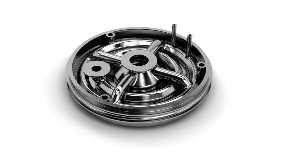

Metal 3D Printing Enables Complex Fuel Injector Design
In addition to several machined components, the aerospace engineering students used metal 3D printing to manufacture the fuel injector. The previous injector design was machined but they chose to switch to 3D printing to eliminate seals, reduce mass, and achieve a higher efficiency design. To optimize the fuel injector’s geometry and reduce mass as much as possible, they built the injector around the fluid volumes instead of carving fluid volumes out of a block—which is what is typically done for machined parts.
Once they had a new injector design completed, the team worked with the applications engineering staff at Protolabs to make a few adjustments to ensure a high quality print. They added in a radius to maximize the overhang angle within the internal channels and groove for the o-ring seal. The team also increased the orifice size from 0.016 in. to 0.020 in. for better feature resolution. The orifice holes were then machined out to remove any remaining material before assembly.
Working with Protolabs’ direct metal laser sintering process they were also able to reduce the part’s wall thickness from 0.050 in. to 0.020 in. Since the fuel injector is essentially channels for the fluids to flow with a shell enclosure, reducing the wall thickness resulted in a mass reduction of 50 percent.
![Luer Lock Animation](/media/1018069/stanford-injector-570x308.jpg?width=570&height=308&rnd=132112914279600000)
“It’s hard to make a complicated injector with the means that students have. But with 3D printing we were able to achieve a high-efficiency injector at a reasonable cost,” explained Nick Gloria, an aerospace engineering student at Stanford. “For this part, we found the cost to be about equal to a comparable machined design but offered us much higher efficiency.”
With the newly designed components manufactured with CNC machining and 3D printing, the engine weighs only 22.0 lbs without fuel. The students calculate that the rocket is capable of producing 400 lbs of thrust, which should enable them to reach their altitude goal of 30,000 ft.
