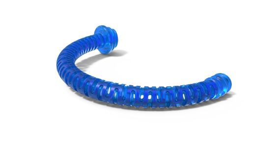

![Elastomeric parts can be used for a variety of functions](/media/1020508/elastomeric-creep-570-308.jpg?width=570&height=308&rnd=132366949351100000)

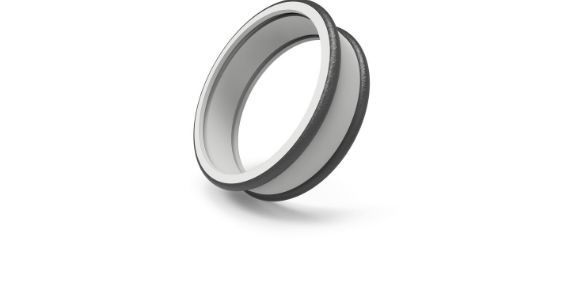

![Elastomeric parts and their functions](/media/1020509/elastomeric-3dp-570-308.jpg?width=570&height=308&rnd=132366950120430000)
