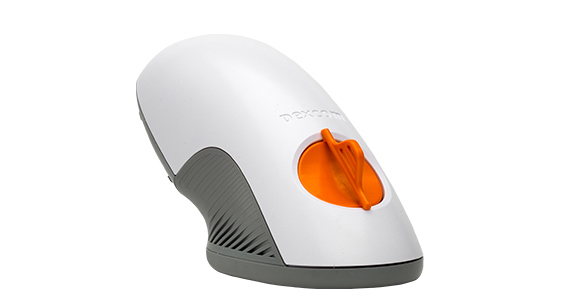

NOVO recently tapped our injection molding and machining capabilities to prototype a new applicator for a glucose monitoring system. In our Q+A, we cover how digital manufacturing fits within NOVO’s design process and the challenges the company overcame during the development of this medical device.

Can you start by sharing the product you designed and how it functions?
We came to Protolabs while we were designing and developing a single-use applicator for the sensor and base components of a continuous glucose monitoring system for patients with Type 1 and Type 2 diabetes. When applied to the body and triggered by the user, the applicator automatically inserts a sensor subcutaneously, makes the electrical connection, and adheres the transmitter base to the patient. NOVO’s role in this product development effort included the initial concept development, feasibility prototypes, and the design and development of early-phase prototypes.

Because our in-house machine shop was overloaded at the time, Protolabs manufactured all plastic components of our machined prototypes used for proof-of-concept and manufactured all injection-molded components of our disposable device used for engineering verification testing (EVT).
What manufacturing challenges did you encounter while developing the glucose monitoring device?
There were several development challenges that we overcame with Protolabs’ manufacturing services. We needed to machine several complex geometries for proof-of-concept models and functional prototypes. Protolabs’ fast lead times for machined parts were critical to keeping our project on schedule and facilitated multiple design iterations.
For our molded parts, we worked with Protolabs to supply a medical-grade thermoplastic that was not on their standard material list. The design also required different surface finishes on certain features, so we applied various mold polishes within a single tool. Some of the tooling incorporated features that could not be generated with conventional machining, so it was necessary to use a combination of EDM and CNC machining to fabricate the molds.
