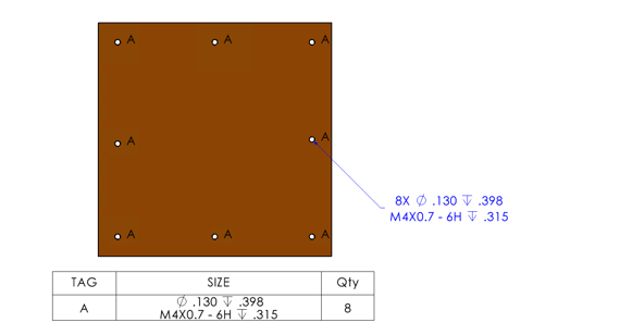

Threaded Holes
- Typical threaded hole annotations are recommended
- Callouts referencing threaded hole type (ex. M4) and count (ex. 4X) are acceptable
- Our library includes ANSI imperial or metric types and all options provide a 2B finish

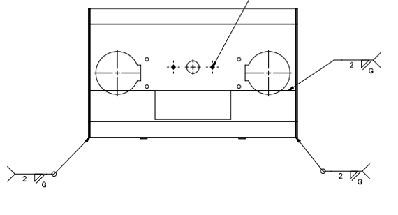

Welding
- Typical weld symbols and annotations are recommended
- Welding type and location information are critical
- We use MIG, TIG, and spot welding processes to achieve full seam, tack, and plug weldments
- Weld studs and nuts are OK to call out

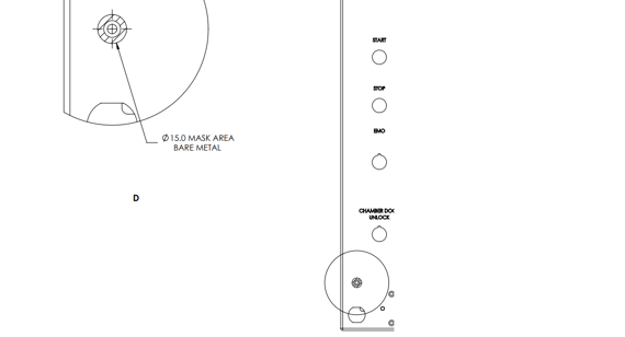

Masked Areas
- Typical masked area callouts and annotations are recommended
- Masking size and location information is critical
- Our standard rounds range from 0.313 in. (7.950mm) to 1 in. (25.4mm)
- Our standard tape ranges from 0.25 in. (6.35mm) to 2 in. (50.8mm)
