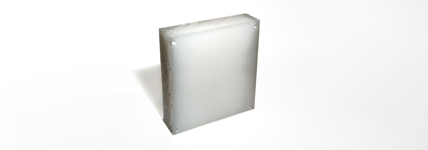

Polypropylene is a lightweight versatile material commonly used for diverse applications like packaging, automotive parts, and electrical components.
