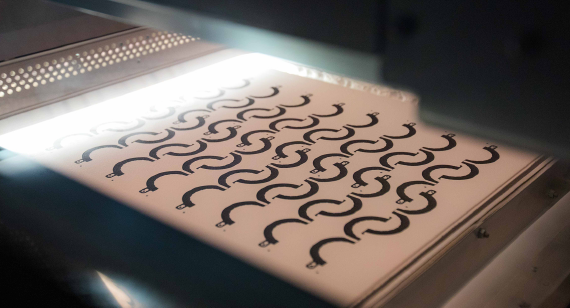

Q: How long does it take to print a full 15 in. x 11.2 in. x 15 in. bed?
A: 8-9 hours at 8-9 sec. per layer, translating to approximately 1 in. per hour. This print speed provides strong economic justification for low-volume, high-complexity mixed run builds or builds of personalized unique parts. It doesn’t matter if you are making 1 part or 100 in the print bed, the speed remains constant. Making good use of space in the machine helps with part cost.

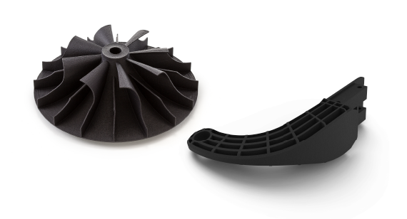

Q: How does this method of 3D printing handle overhangs and support material?
A: A primary strength of the technology is that allows for design freedom. The powder itself acts as the support structure, so design is not constrained by overhangs or support structures. Just remember, you must stay within confines of printer, within min. feature size, and be sure to consider ways to combat material warpage (add radii, uniform wall thickness, etc.).

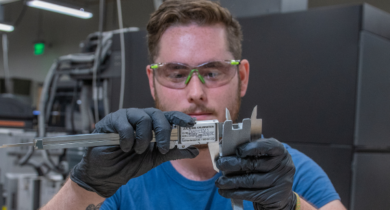

Q: How do tolerances compare between MJF and injection molding?
A: MJF is typically +-0.012 in. and molding for Protolabs is +-0.003 in. plus material shrink rate.

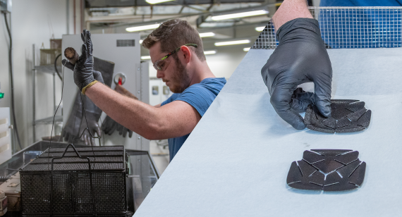

Q: What are the options for custom coloring for MJF? Can dyes be custom colored or would they need to be painted?
A: Our standard process is to dye parts black. We can apply custom dying and custom painting to your MJF parts. For example, if wanting a dyed yellow part, a bright yellow would be hard to achieve. Expect a more Dijon mustard yellow. We have found that MJF does take matte paint very well. And, of course, HP does offer color production printers.
Q: Is the vapor polished part you're demonstrating also painted?
A: None of the parts are painted, but MJF parts do take matte paint well.

Q: Is MJF print technology seen as the most mature and capable for end-use production parts?
A: Absolutely. MJF is the leading 3DP technology for low-volume production plastic parts. It’s an ultra-versatile nylon material. The part finish off the printer is production quality and there are no layer lines. It prints faster than SLS, making it a very economical printing option for end-use part production.
