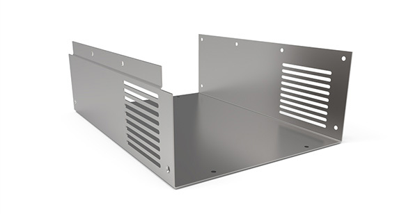

Sheet metal is a popular option for enclosures and offers a variety of potential features, such as flanges slots, and screw holes with countersinks.
The go-to process for making enclosures for computer parts, panel boxes, and electronics bus bars is sheet metal fabrication. Sheet metal enclosures or parts are cut from a thin, flat piece of metal, bent into shape with a press brake or folder and, sometimes, welded. Holes for cables or louvers for venting are laser cut from the sheet before the bending starts. Though light, metal enclosures are highly durable and the material typically is affordable.
Designs likely have to be less complex because of the limitations and safety concerns involved in manually bending a piece of metal. With fewer material choices than for other processes, most sheet metal enclosures are made from aluminum or stainless steel.
We have thousands of sheet metal hardware options for integrating nuts, pins, studs, and other connectors, or threaded or unthreaded standoffs to provide space between connected parts.
Powder coating—like a dry paint that is applied and baked onto any electrically conductive metal, is a popular finish for metal enclosures. It’s faster, cheaper, and more durable than paint, especially outdoors. Also, it looks great.
With a box-type enclosure, small notches or bend reliefs can keep the metal from bulging outwards and leaving a slight gap where two flanges come together. Or, those areas can be ground smooth, welded, and powder-coated so it looks like one solid part. Two design features to consider if you want to eliminate sharp edges on sheet metal enclosure parts a radius—or rounded corner—or an angled/beveled corner known as a chamfer.
A customer may need only a small number of sheet metal enclosures. But once the setup is in place to produce them, making more will cost less. Parts can be available as fast as three business days, but powder coating, hardware installation, and welding may add a day or two to that.
