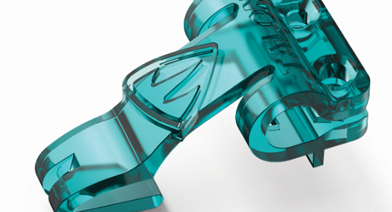

A molded TPU part
Thermoplastic polyurethane has excellent chemical and abrasion resistance.
