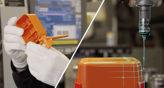

Design vs. Process Verification & Validation (V&V)
First, I want to ensure we establish a baseline as this will be important as we unwrap this strategy later on. Let’s look at each a little closer.
- Design. The specification and user requirements of a device and final assembly. Take a bike, for example, to help convey the design V&V, specifically the bike tire. The verification would be inspecting the diameter of the wheel while the validation would be determining if the wheel rolls when riding the bike. One provides statistics, while the other is more contextual because it asks, “How does the wheel work within the bike assembly?”
- Process. How do the manufacturing inputs define the outputs. Using the same example as before, we can look at the manufacturing of a bike wheel. During manufacturing, verification means measuring a single bike wheel diameter while the validation is understanding the process inputs that determine the output of diameter over the course of a normal production run.
- Process Development Strategy. Worthy of an honorable mention is robust process development as it makes up the core building blocks that provide the best chance for building a stable and capable process. For example, injection molding uses the scientific molding It’s the gold standard when it comes to developing a solid starting point.

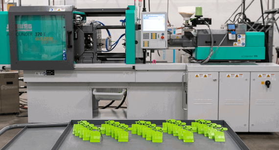

![](/media/d1ubzsww/blog_process_validation_3_im_parts_570x308-1.png?width=570&height=308&rnd=132802358207030000)
The Difference Between Qualification and Validation
Fundamentally, qualification is a simpler version of validation, and when coupled with sound process development it can be a rock-solid starting point for full validation activities. Qualification considers a single point within the process window at an increased sample size to determine if the process is capable. It’s sometimes called single-point validation. Although smaller than a full validation it packs a punch when delivering a high level of confidence for the main event. Still, it begs the question: Why not perform verification and validation back-to-back and skip qualification altogether?
First, prototyping and production are traditionally done at different locations. So, it goes without saying that waiting to perform validation until work is being done at the final manufacturing location makes sense. The second reason is a business strategy to reduce development costs until the final production development process. Validation is not required until just before commercial release. That’s a great reason to avoid the capital investment of process validation until after the product has proven it is capable of meeting user requirements.
No matter what, it all boils down to a single important question: What if validation fails? If normal process variation is larger than the designed tolerance, you’re setting yourself up for failure before even getting started. This is precisely where qualification becomes an integral part of the process—it helps drive up confidence in later success.
