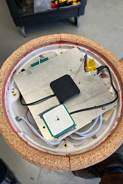

![The capsule interior including the internal housing](/media/c51nsqch/internal-housing.jpg?width=400&height=600&rnd=133362236437430000)

The team has used Protolabs for the last few years to 3D print the components’ internal housings for multiple missions. “We like that they’re lightweight and durable and that Protolabs can design to the exact specifications that we want. We went with Protolabs for the original KREPE mission, and we are again for KREPE-2. We 3D-printed some initial iterations in-house, but they couldn’t compare to the durability and quality of the ones that we get from Protolabs. We plan to continue working with you in the future because the internal housing is such an integral part of our payload and it’s where we house all of our electronics,” explained Ford.
When designing components to be used in space flight, several extreme conditions need to be considered. Ford explains that upon atmospheric re-entry, temperatures can get so hot, it can melt wires and singe metal, but the internal housing itself isn’t being exposed to these conditions. A heat shield, which takes the brunt of the heat exposure encapsulates the entire internal housing. The most important material property for the internal housing is maintaining structural integrity. “Although it’s not experiencing any kind of impact, there are a lot of vibrations that the capsule undergoes, especially during launch,” said Ford.
Ford worked with our applications engineers to settle on 25% mineral-filled PA12, a durable nylon material selected for both its stiffness and high-temperature resistance. Each part was printed via selective laser sintering (SLS).
The team is headed to NASA for extensive vibe testing, where the capsule is tested and shaken up it in multiple orientations to simulate the vibrational load experienced during launch.
“If we had something a little less structurally sound, there’s a high probability that those launch vibrations could crack it or damage the internal housing, which would compromise our mission because everything is held together by it. If it were to crack or splinter, that would be catastrophic for our mission,” said Ford. That’s what we like about the Protolabs manufactured one. Because it’s experiencing such high vibrational loads, we need to trust that our internal housing is not going to crack or fall apart on us, because everything is kind of hinging on that structure.”
