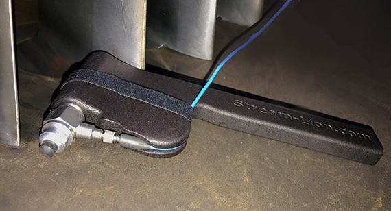

There was one problem with this approach—these types of tests are best suited for a laboratory setting, not inside a combustion turbine.  The tests required Sickles to physically climb into the engine to perform hundreds of vibration tests. It didn’t take long for him to realize that the modal hammer normally used in the laboratory was not designed for this particular application.
He quickly found it extremely difficult to maneuver the hammer within the engine. He noted, “While going into the turbine engine, it was a pretty cramped environment, there was little to no visibility of the parts during the testing process.” This made it difficult to cleanly strike with the hammer, resulting in poor data.
He was also unable to test the parts quickly enough because the hammer was too cumbersome. “When you’re at a power plant doing this type of work, everything must be done as planned and on a strict timeline,” Sickles explained. “I had to get in and out fast.”

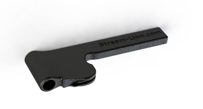

After experiencing the shortcomings of the commercially available hammer, Sickles started envisioning a new modal hammer that could perform better in an industrial environment.  So, as any engineer would do, he decided to take measures into his own hands and create a new design. He wanted to improve the hammer’s ergonomics, reduce its size, and incorporate other enhancements to make the data collection process faster and more reliable.
“I looked at the tool to see how I could improve it. I began thinking about changes I could make and then used 3D printing to prototype the device.”
Using 3D printing, Sickles worked through several iterations before finalizing the design. For the final part, he turned to Multi Jet Fusion, a production-grade 3D printing process developed by HP.
“I looked at the tool to see how I could improve it. I began thinking about changes I could make and then used 3D printing to prototype the device,” said Sickles. “I experimented with different prototypes to validate the new design.”
As he worked through several iterations and the final design came into focus, he began considering how the part would be manufactured. “The new design was such an improvement that I started gaining interest from others wishing to purchase this tool. I was now faced with figuring out how to make the improved hammer available to customers,” he explained.
Sickles outlined several key priorities for the production part as he searched for a suitable manufacturing process. The final part would need to be durable enough to withstand repeated impacts, have tight tolerances to properly interface with force transducer components, and, since he would likely only need a few parts at a time, be economically produced at low volumes.

The first prototypes were built on Stream Lion’s desktop 3D printer, but Sickles knew that durability and overall quality would need to be better for a robust end-use part.  This is when he turned to Protolabs.
After discussing the part’s requirements with a Protolabs applications engineer, he weighed the benefits of building the part through selective laser sintering (SLS) or Multi Jet Fusion (MJF), both production-grade 3D printing processes.
Sickles’ final decision was to use MJF due to lower costs, finer feature precision, and the higher quality surface finish compared to SLS. This production-grade 3D printing technology would enable him to build a durable nylon part with precise features that properly fit to other parts in the assembly.

The new hammer design was successful in solving the issues Sickles encountered with the off-the-shelf tool. Not only was it more ergonomic and easy to use, but the 3D-printed part had the strength and durability to last in the field. Sickles states that the new hammer enabled him to double the speed that he could collect data.
 “Right out of the box, the part was a huge success. The tolerances were exactly what I needed.
“Besides function, it was important that the part had the right surface finish and durability, since this would be used in the field and wasn’t just a prototype,” he said. “Right out of the box, the part was a huge success. The tolerances were exactly what I needed, it fit within the assembly perfectly, and the bead blast and black dye finish looks great while giving the hammer the perfect texture.”
