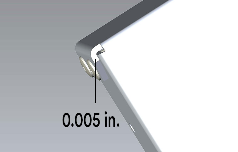

Mating Components: Mind the Gap!
Sheet metal tolerances are significantly looser than those for standard machined parts, which have a tolerance of +/-0.005 in. (+/-0.127mm). In fact, if you are crossing multiple bends with your dimension the tolerance could be as loose as +/-0.030 in. (+/-0.762mm).
For example, when you are designing components that will be riveted together, it's important to think about this tolerance range and afford design accommodations, preventing components that can't mate because of interfering tolerances once fabricated. This mindful design philosophy will make the assemblers job quicker and easier with fewer opportunities for quality failures and non-conforming product.
A good rule of thumb is to allow for 0.005-0.010 in. (0.127-0.254mm) between your components. Also keep in mind that powder coating adds 0.002-0.005 in. (0.051-0.127mm) to your material thickness. So, if your parts are powder-coated, lead towards the large end of the gap range.
If that baseline separation between components is present, our programming department will do their best to adjust the geometry and maintain your original design. Lastly, following gap guidelines will reduce potential design-for-manufacturing (DFM) issues identified by our automation software, preventing additional processing time for your quote as well as when we get started on your order.
Part rendering with tolerances
To ensure that your assemblies come together properly, always add between 0.005 and 0.010 inches of gap between parts. Add more gap between powder-coated parts.
