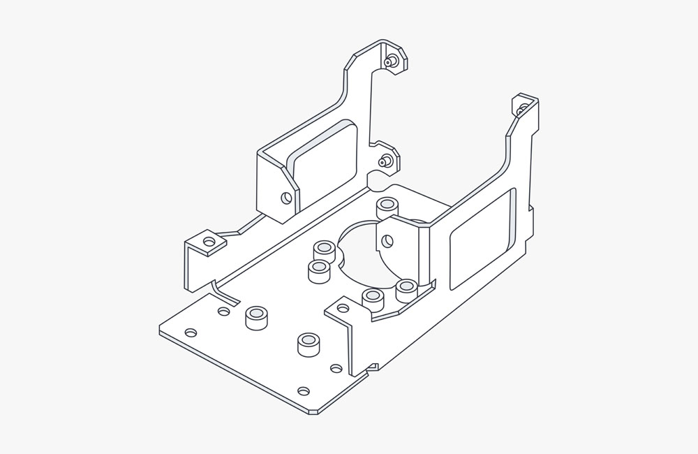

Part illustration

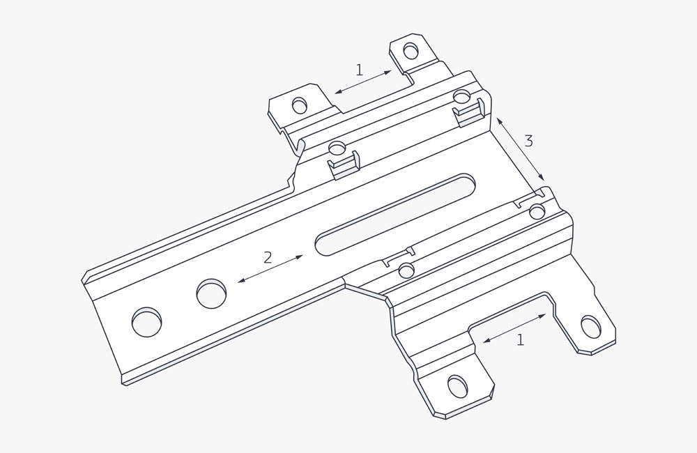

On Z-shaped offset (1) features, try to keep all the bend radii the same, with 0.030 in. the preferred radius, and parallel planes should be at least two times the material thickness apart. With holes and slots (2), place at least 1/16 of an inch from the nearest wall or part edge for materials 0.036-in. thick or less, and 1/8-in. or more from the edge on everything else. Tabs (3) on either side of a notched feature should be at least 0.126 in. or two times the material thickness across (whichever is greater).
Also, keep in mind that metal resists bending. To prevent cracks and meet a +/- 1-degree bend tolerance, Protolabs will place bend reliefs in strategic part locations—with a box shape, for example, the corners will be relieved slightly to allow the flanges to meet properly. The total amount of bend relief in this case will not exceed the bend radius plus the material thickness, and be no wider than 0.030 in.

These should be placed at least 1/16 of an inch from the nearest wall or part edge for materials 0.036-in. thick or less, and 1/8-in. or more from the edge on everything else. Hole and width tolerances will be +/- 0.005 in. unless otherwise specified. Check with the manufacturer if an insert will be used, as additional clearance may be required. If using the eRAPID SOLIDWORKS plugin, all holes and slots should be a minimum of four times the material thickness from any part edge or feature.
Tabs and Notches
Sheet metal parts often require notches to accommodate a screw or other fastener. These should be one material thick or wider and extend no more than five times the slot width into the workpiece. Similarly, the tabs on either side of a notched feature should be at least 0.126 in. or two times the material thickness across (whichever is greater) and again, be a maximum of five times the part thickness in length.

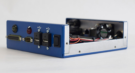

A computer chassis requires a number of processes including forming, laser cutting, punching, hardware assembly, powder coating, and silk screening.

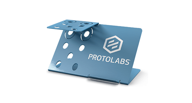

Want to create designs that convert flat sheets of metal into fully formed three-dimensional parts? Incorporating everything from countersinks and punch-outs to powder coating and silk screening, our functional design aid will show you the way. The Z Frame explores fabrication processes unique to sheet metal and design elements that will improve the structural integrity and appearance of your parts. It even doubles as a desktop organizer.
