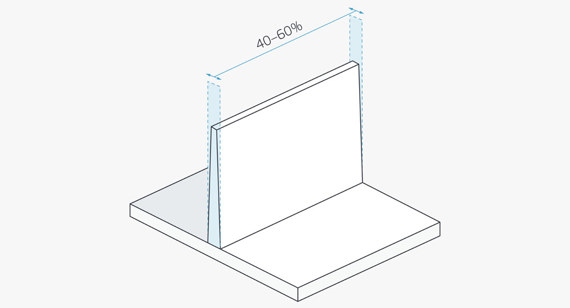

Uniform wall thickness in injection molding
Strive for uniform wall thickness with molded parts. If you do need to design thinner walls in certain places, they should be no less than 40-60% the width of adjacent walls.
1. Avoid Non-Uniform Wall Thickness for Molded Parts
When designing a part for injection molding, having the wall thickness come as close to uniform as possible will make for a stronger part. Otherwise, for example, thinner areas will tend to sink and warp. If you need to design thinner walls in places, they should be no less than 40-60% the width of adjacent walls. And watch out—some materials have quite specific thickness requirements to keep parts strong. Knowing material specifications can save you a lot of pain later.

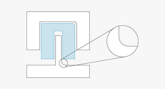

Use radii in injection molding to eliminate sharp edges
Build radii wisely, only in necessary areas, for example, to eliminate sharp edges on the surface of the part that an end user may touch, or in critical functional areas such as a lead-in to an assembly.

5. Use Radii Wisely for Injection Molding
Building radii into a part can be a hit and miss proposition. Only use them in necessary areas, for example, to eliminate sharp edges that an end user may touch, or in critical functional areas such as a lead-in to an assembly.
Some radii are used on inside corners of critical features to make more robust geometry. Inside radii can also help on material flow patterns. In general, proper placement of corner radii can create stronger molded parts.
6. Be Careful with Parting Lines and Radii for Molding
Parting lines always make for interesting design and manufacturing challenges. Typically, we want them to be as unnoticeable as possible, and deciding where to locate them is an exercise filled with aesthetic and mechanical considerations. But watch out. If you try putting a fillet or radius around a parting line, you might end up with undesirable minor undercuts in your mold and maybe even flash.

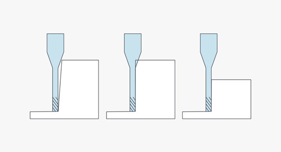

Adding draft angles to injection molding design
Adding draft angles to design helps facilitate ejection of a part from a mold and improves overall moldability.
Draft/Thickness
Our standard injection molding process relies on high-speed milling. As a general rule of thumb, use 1-degree of draft per inch of depth, and enough thickness to allow cutter penetration.
