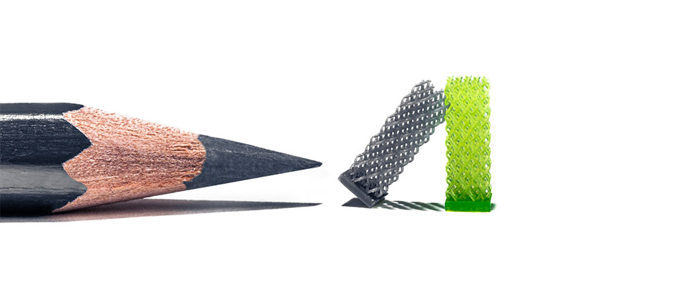

If you need insanely small layer thicknesses and feature sizes, MicroFine™ is the way to go. Yes, these printed parts are this small!

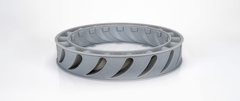

ABS-like plastics offer strength, durability, and versatility, all in one group of materials.

MicroFine™ is an exclusive Protolabs material that can build ultra-fine features in micro resolution. MicroFine™ is available in a green or gray color. Layer thicknesses of 0.001 in. and feature sizes of 0.0025 in. are possible with MicroFine™ to accommodate applications that require parts that are generally less than a cubic inch in size.
