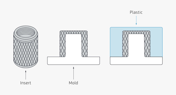

Insert molding allows you to build added strength into parts with prefabricated components like threaded inserts.

But where overmolding is a two-step process, requiring one shot for the substrate and another for the overmold, insert molding is, as an industry saying goes, “done in one.” The threaded insert, bushing, sleeve, or boss is manually placed into the mold, the mold closes, plastic flows, the mold opens, and the part is ejected. The result is improved part strength and reliability.

insert molding illustration
A threaded insert is placed atop a mold core where plastic is molded over it to form the final component.
