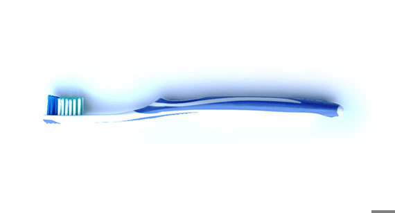

Toothbrush
What is an Overmold?
What do you do when you need a part made from two or more materials at the same time. Most commonly, these parts have a rigid section and a flexible section. The rigid section is called the substrate and the flexible section is called the overmold. A common example of an overmold/overmolded part is your toothbrush! The white, rigid part is the substrate, and the blue, flexible part is the overmold.
