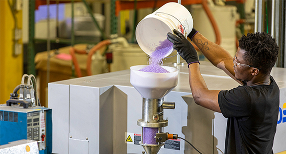

Man dumping materials into hopper of machine
Plastic pellets are placed in a hopper to be melted to form an injection-molded part.

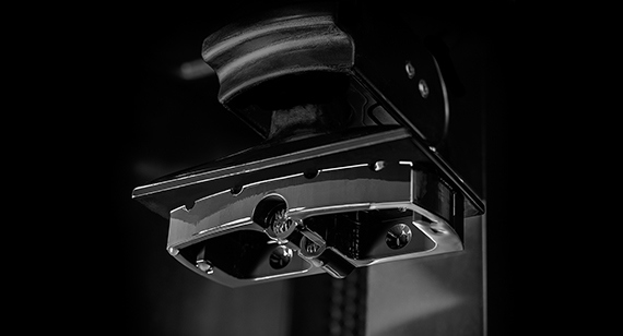

Carbon ABS Part
Carbon DLS creates polyurethane end-use parts with mechanically isotropic properties and smooth surface finishes.

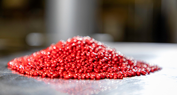

Red PET materials in pile
A pile of PET (polyethylene terephthalate) pellets to be used for injection molding.
4. PET
PETG, also known as polyethylene terephthalate glycol, rivals PC for its optical and impact-resistance qualities but is much less expensive. It's food grade and biocompatible, so it’s suitable for single-use drink bottles and leftover containers, can be sterilized for use in medical packaging, instrument trays, and even implants, and offers excellent chemical resistance. It's also easy to injection mold with good thermal properties and dimensional stability.
