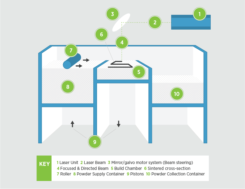

Selective laser sintering (SLS) is a close cousin to direct metal laser sintering (DMLS), but builds parts made of plastic rather than metal. SLS uses a computer-controlled CO2 laser versus an ND: YAG fiber laser for DMLS, but both “draw” slices of a CAD model in a bed of material, fusing micron-sized particles of material one layer at a time.
SLS needs none of the support structures typical with DMLS, however, and unlike stereolithography (SLA)—the third laser-based additive manufacturing (AM) process available at Protolabs—SLS creates fully functional parts using engineering-grade nylon, and is essentially the only AM technology able to create living hinges and snap-fit assemblies. (These features can be produced with SL, however, they will be much more fragile and not have the life expectancy of those produced with SLS). This makes it an excellent way to prototype injection-molded products, and can even be used as a low-volume alternative to molding in some cases.

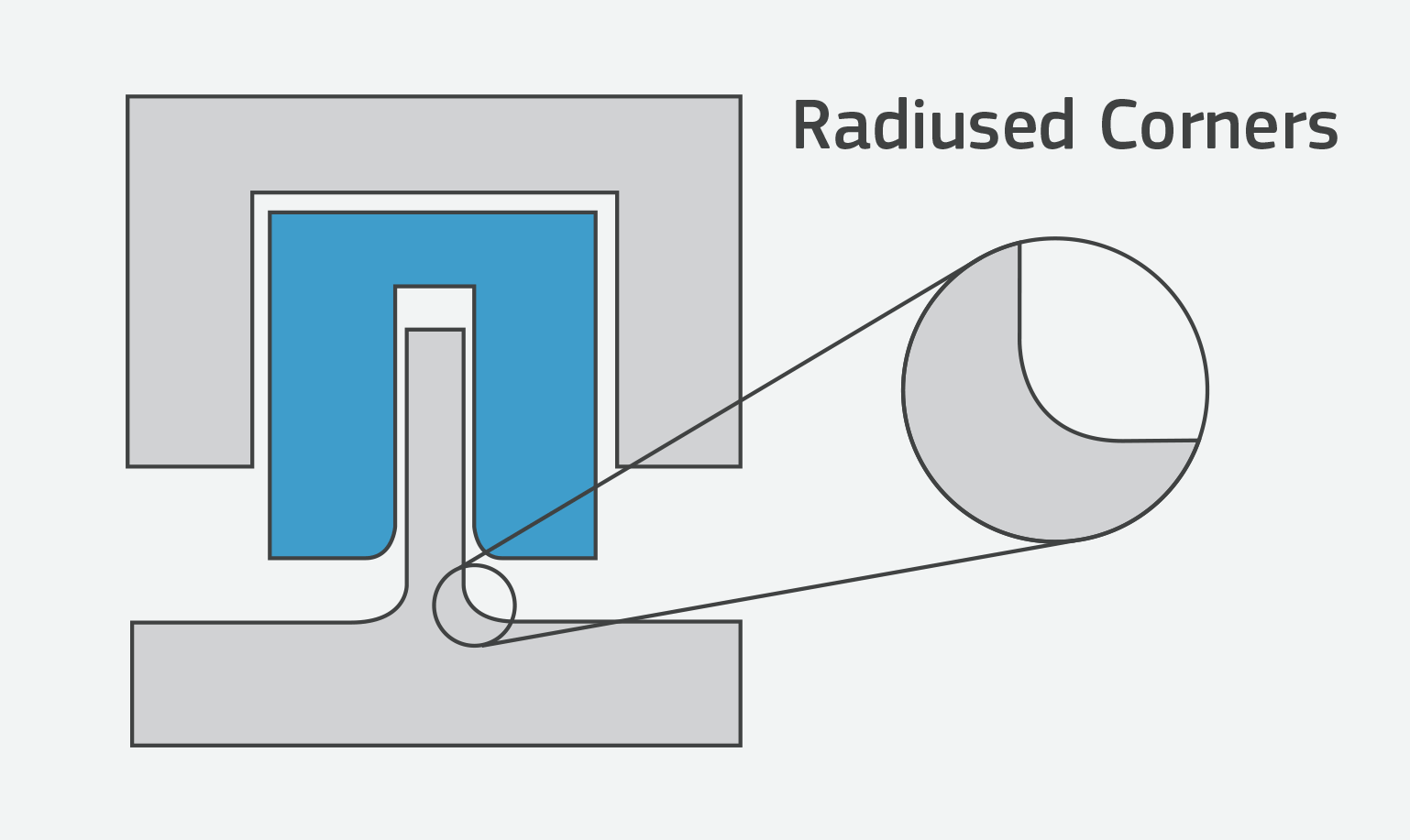

Many of the rules applied in injection molding also apply to SLS, making it a solid choice for parts that will eventually be molded. The use of hole bosses and support struts, and avoiding thick cross-sections are good practices for either manufacturing process. Additional design considerations include:
- adding corner radii where walls meet to reduce stress
- uniform wall thickness—between 0.060 in. and 0.150 in. is recommended to reduce in-build curl and potential for warping
- integrating ribs to reduce warping
