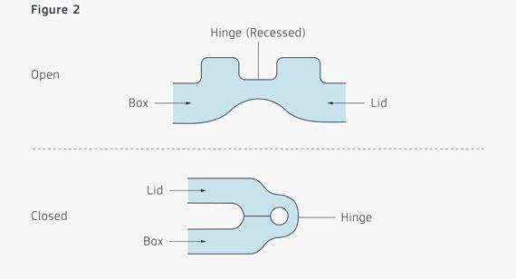

With paper, you could do it by raising the mating surfaces above the level of the hinge, say by adding sheets of cardboard to them (see Figure 1). This ensures that when the paper is folded, the cardboard surfaces lay flat against one another while the paper at the fold retains a radius that prevents permanent deformation of the material. In plastic, you can accomplish the same thing by slightly recessing the living hinge below the level of the mating surfaces it connects (see Figure 2). Without that recess, one of two things will happen to the living hinge when folded:
- The plastic in the hinge will resist being forced into too small of a radius and will prevent the adjoining surfaces from meeting flat. That’s good for the hinge and preserves its integrity, but it’s bad for the overall performance of the design.
- The surfaces can be made to meet either by shortening the hinge or by applying force to the mating features to press them together. This over stresses the outside of the hinge, weakening or tearing it. (See Figure 3.)
