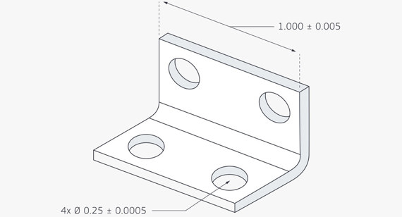

Tolerancing Guidelines for CNC Machining
Overconstraining a design can take two forms: adding an unnecessarily tight tolerance, or constraining each degree of freedom more than once. A single pin constrains x and y, while a second pin prevents rotation. The same applies to slots and inserts, and overconstraining will add cost.
Tolerances can be bilateral (± 0.005 in), unilateral (+ 0.000/-0.010 in) or limit dimensions (1.005/0.995 in). All are acceptable, in imperial or metric units, provided they are stated clearly on the drawing.
