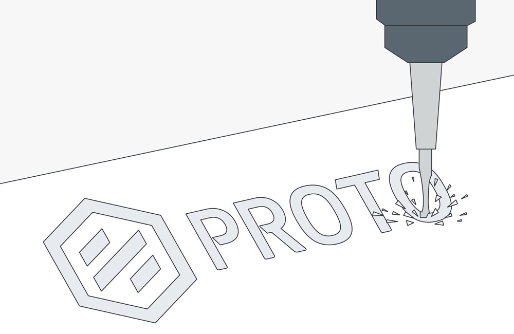

3. Avoid Text Until Molding
Similarly, text engraving is an aesthetically pleasing but time-intensive operation, one that might be best to avoid if possible. Here again, a ball end mill is used to trace whatever letters, numbers, and symbols are called for on the CAD model. It looks cool, and might be a valid requirement on your machined part, but is probably more appropriate on injection-molded parts, where additional machining time is amortized over higher part volumes. Because of our toolsets for metals vs. plastics, we have a minimum feature size of 0.035in (0.90mm) in metals and 0.020in (0.51mm) in plastic.
Illustration
Small tool diameters add machining time so consider removing text or logos from machined prototypes.

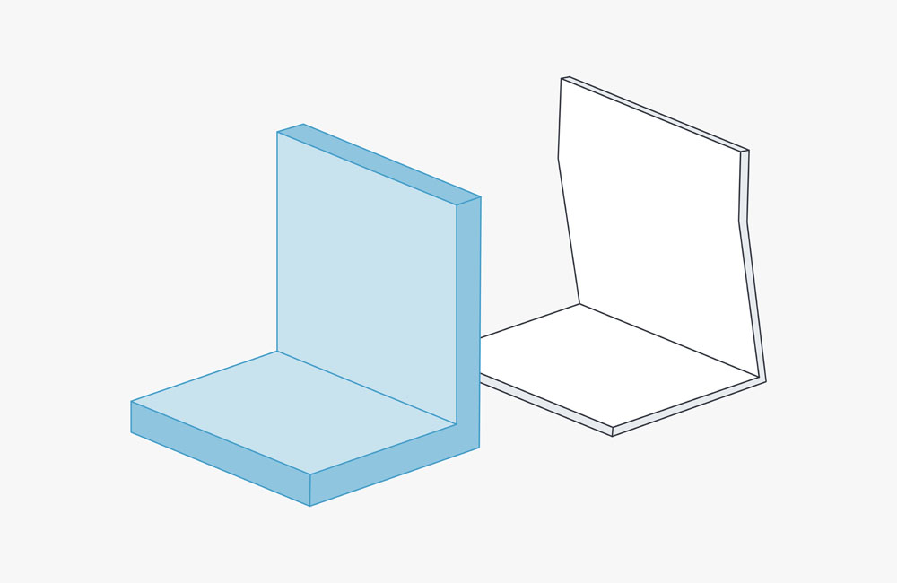

4. Be Cautious of Thin Walls and Features
Our standard part tolerance is +/- 0.005 in. (0.13mm). If you have a feature that is 0.020 in. (0.51mm) or smaller, our automated quoting system will highlight it as a thin-wall geometry, but keep in mind that we'll still allow it to be machined—so the machined part may differ slightly from your original design. Any thin walls that are 0.020 in. or less are not only subject to breakage during the machining operation, but may flex or warp afterwards. Beef them up as much as your part design allows.
Illustration
Use caution with thin-walled parts because they are subject to breakage during the machining operation or may flex or warp afterwards. Beef them up as much as your part design allows.
