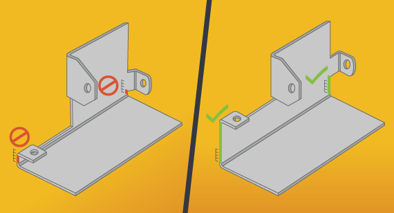

2. Placing Features too Close to Bend Lines
A quick way to create difficulties during manufacturing is to place holes, tabs, or other features too close to a bend. So, how close can you get? Just follow the 4T rule. Keep all features at least 4x material thickness away from bend lines. So, if your design tells us to use 0.050 in. (1.27mm) copper, give your feature at least 0.200 in. (5.08mm) of clearance. If you don’t, the part will deform awkwardly in the press brake, and no one wants that.

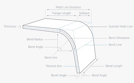

3. Designing Perfectly Perpendicular Sheet Metal Corners
When you bend sheet metal in a press brake, the resulting bend doesn’t form a perfect 90-degree angle. Instead, the tool has a rounded tip that adds a radius to the bend. If you measure the length of that bent area and divide it by two, you’ll get the bend radius, a figure that is defined by the tool that made it. If the size of that curve is important to you, make sure you specify it in your model.
The most common internal bend radius (and our default) is 0.030 in. (0.762mm). An important consideration to remember is that the external bend radius—the one formed on the die side of the press brake toolset—is equal to the material thickness plus the internal bend radius.
Some designers like to get fancy and create different radii for each bend in a part. Want to save some money? Use the same radius for all of the bends. When your manufacturer doesn’t have to change tooling that saves you on labor costs.

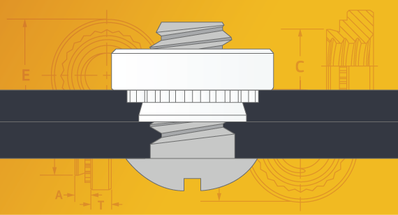

4. Forgetting to Include Detailed Hardware Specs in your CAD File
Do you know of anyone who wants longer lead times? Probably not. Always remember to let your manufacturer know what kind of hardware you want to use by including the details in your top level assembly information. Whether it’s a self-clinching nut like CLS-440-2, flush-head stud like FHS-M5-15, or other hardware, this guarantees that you’ll get exactly what you want placed in the location you expect it. To save yourself time and trouble, download and use the PEM clinch hardware models.

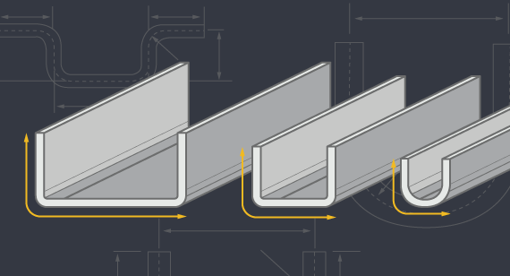

![U channels on sheet metal parts](/media/1019215/pl-dt-feb-strong-u-channels-570x308.png?width=570&height=308&rnd=132249386215800000)
7. Failing to Consider U-Channel Strength
When designing U channels, always think about the strength of the material you’re using and how easily it can bend. At Protolabs, narrower doesn’t work for us because of our tooling. If we had narrower tooling, we could manufacture narrower U channels. The bottom line is that it is best practice when working with us to maintain at least a 2:1 width-to-height ratio for your U channels. If you need a narrower channel, consider a welded or riveted assembly.
