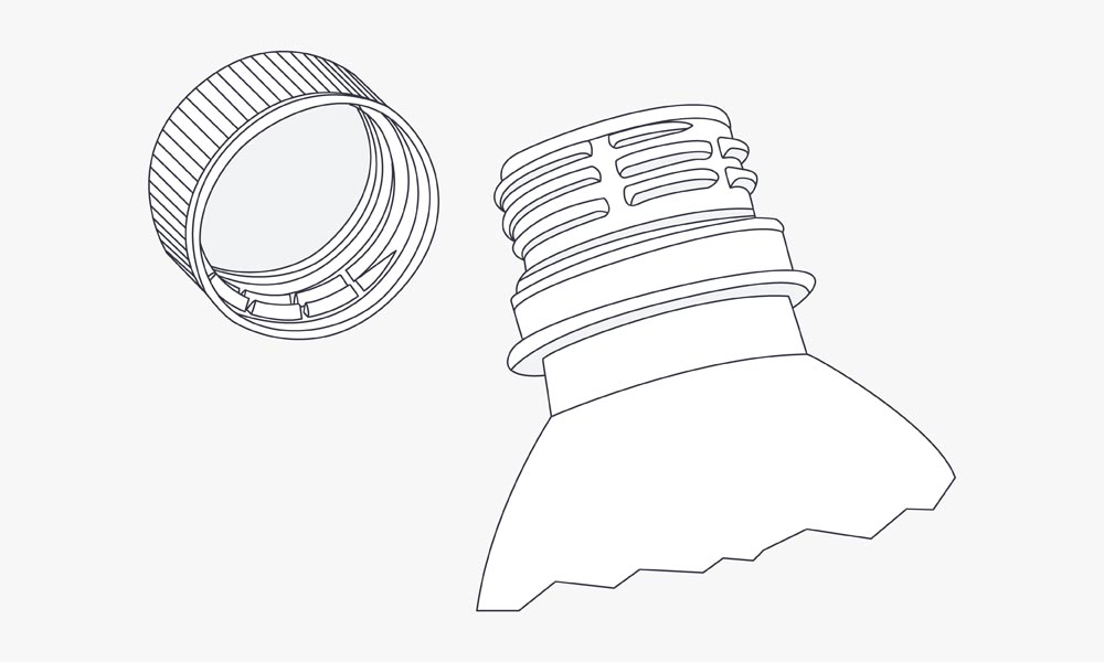

Molded threads are ubiquitous. Soda bottles and caps are prime use-case examples of plastic molded threads.

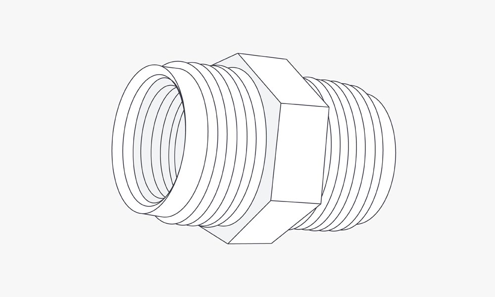

Originally, screw threads were designed for metal parts, though molded threads on plastic parts are now also common, as seen here on this threaded bolt. Just carefully consider thread size and pitch when designing your part to avoid threads that might strip more easily than metal counterparts.
