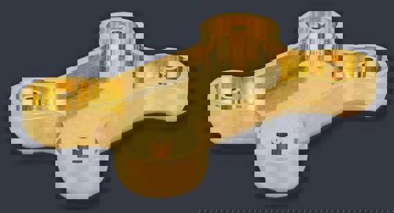

Zinc, Tin, Gold, Silver, and Other Plating Options
The electroplating process just described can be applied to other metals as well. Exchange the nickel anodes for ones made of zinc, for example, and you’re left with a plating that’s great at protecting iron and steel from corrosion. Zinc should not, however, be used where parts will see temperatures greater than 500 degrees F or in marine environments. See see zinc coating ASTM B633-15 for additional information.
Due to its low cost, tin plating is also quite common. It is a soft, ductile, silvery-white metal that is not only corrosion-resistant but quite agreeable to soldering, so it is often used in the electronics industry for computer chassis and other components. Hot dip tin plating is also possible, which together with its electroplated alternative is described in MIL-T-10727 (MIL is a military specification coating).
Then there are gold and silver plating options. From an electronics industry perspective, both are similar to tin, albeit with higher conductivity, solderabililty, and corrosion resistance, with a higher price to match. And as evident from their use in the jewelry and dinnerware markets, they have an attractive appearance. These and other metals may require that a “nickel strike” is applied to the surface before plating to improve adhesion. Nickel plating provides excellent adhesion properties, so it is often used as an “undercoat” for other coatings.

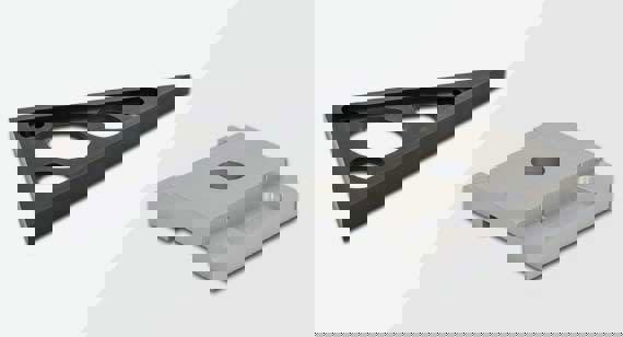

Three types of aluminum anodizing are available. Chromic Acid anodize (Type I) provides a whisper-thin but still durable coating, typically between 0.00002 in. and 0.0001 in. (0.00127mm and 0.00254mm) thick. It is gray in appearance but can be dyed a dull, non-reflective black. It's commonly used for welded parts and assemblies, and as a primer before painting. Like all anodized surfaces, it is non-conductive.
Harder yet is Type II Sulfuric Acid anodize, also known as decorative anodizing for its ability to absorb practically any color dye. That said, it offers an exceedingly durable finish up to 0.001 in. (0.0254mm) thick that is also quite attractive. Everything from carabiner hooks and flashlight handles to motorcycle parts and hydraulic valve bodies can be Type II anodized.
Beyond this is Type III Hard Anodize, or Hardcoat. Its color ranges from dark gray to bronze-like and is the thickest anodize available, adding as much as 0.003 in. (0.0762mm) to a part diameter and twice that to threads. Where the dimensional impact of most coatings and platings is fairly minimal, Hardcoat is just the opposite, and must be considered when designing close-tolerance parts.
