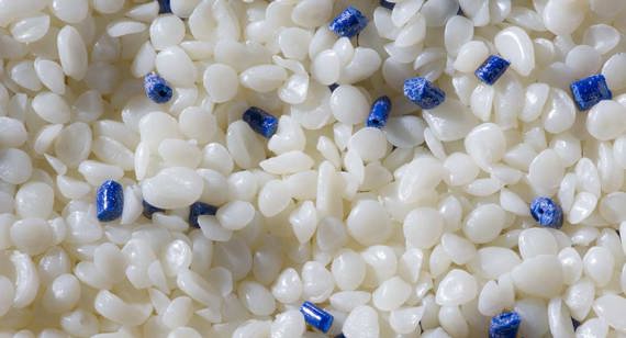

Let's switch gears now from additives that modify the mechanical properties of resins to ones that provide cosmetic modifications—colorants. Protolabs offers a limited selection of colorants (about 45) as well as custom colorant (based on a Pantone number) that we can add to a base resin at no additional charge. Thermoplastic base resins primarily consist of black, natural and clear, and colorants can be added to the latter two. We generally employ a 3-percent salt-and-pepper mix, with smaller percentages for transparent resins like polycarbonate. Note that the mix is not an exact color match; even though a particular material can accept a particular colorant, part colors are approximate. If you upload a 3D CAD model, our ProtoQuote system will automatically indicate which colorants are compatible with which materials.
Pre-Compounded Resin
When your product requires exact color matches or the use of multiple additives to ensure your parts and resin selection perform in their intended environment, you will need to supply your molder with a pre-compounded resin. Pre-compounding means a resin supplier like polyone.com or RTPcompany.com will mix all of the additives into one pellet ensuring uniform distribution and color. All pellets are the same in pre-compounded material rather than the salt-and-pepper mix that has a random dispersion of pellets.
